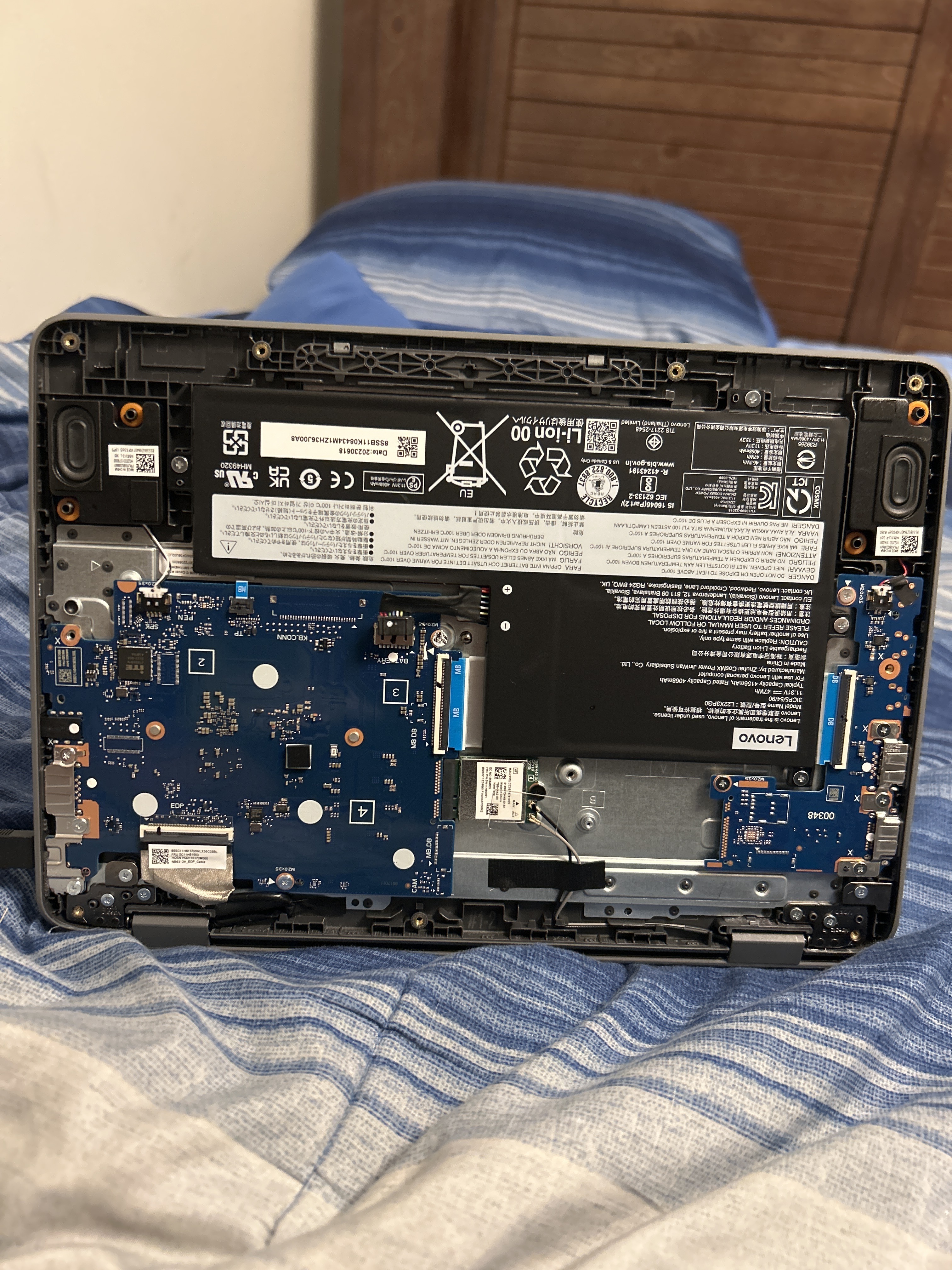

Yo, I have that same model and desperately need help. Here is an image of the inside components if that helps anything
According to the above posts this device uses the Cr50 wp disable method so y can follow these instructions:
Remove the bottom of the laptop and disconnect the battery.
Plug the charger or AC adapter into the port and LEAVE THE BATTERY DISCONNECTED.
Power the device on and make sure you are in developer mode.
Enter the VT-2 shell by pressing CTRL+ALT+F2
Login as chronos and type sudo -i
Type flashrom --wp-disable
Once its done then you can reconnect the battery and close the device up.
As far as I know the firmware script DOES NOT support arm devices. I can’t garantee it’ll work.
