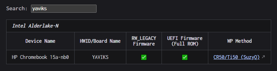

that is not the expected behavior at all. Why do you think it should? My site does not list battery disconnect as a WP disablement method for your device.
That’s because the device you’re using, YAVIKS, doesn’t disable write protection through disconnecting the battery. As stated by the MrChromebox Supported Devices page, your Chromebook can only disable write protection through a Suzy-Q cable.
