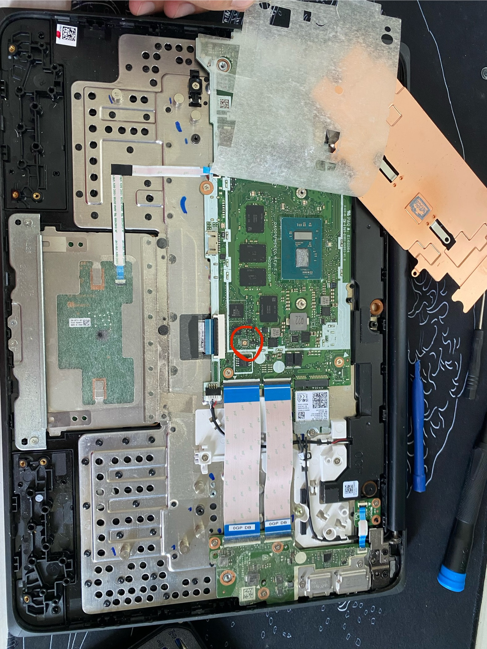

I recently got a chromebook HP (Fortis 14g10) but I really don’t like ChromeOS and want to go back to debian, which I used on my previous computer.

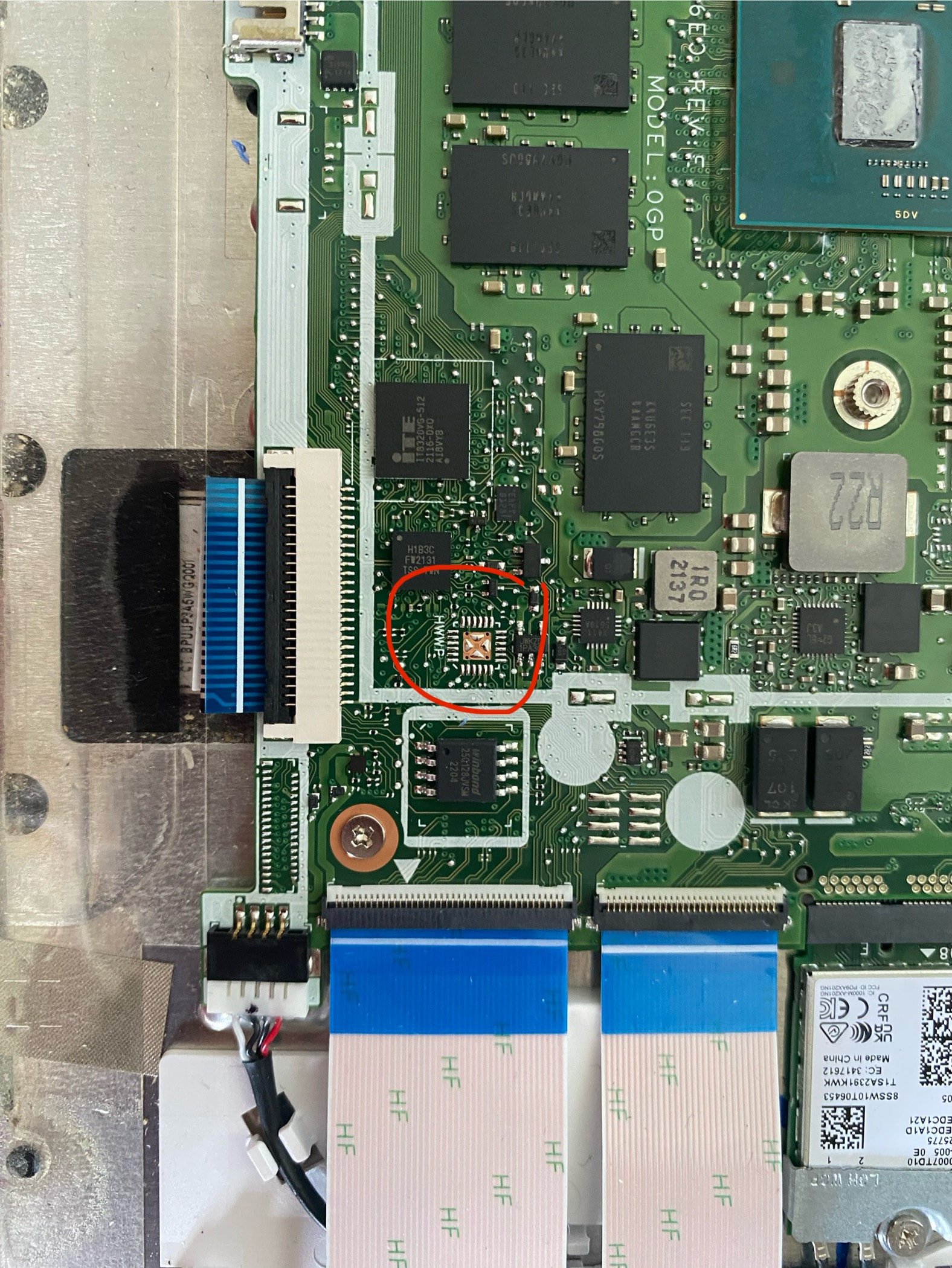

I know I have to remove the WP but after opening the laptop I couldn’t find the precise pins that were presented on MrChromebox website. After removing the heat sink I might have found it (red circle on the picture) but I would like some confirmation, plus if anyone knows how to jumper it that would be nice. I think it’s a jumper but I’m not sure (I’m better with software than hardware so some help would be nice).
that’s not where it shows it on the picture on MrChromebox’s site, but I think it’s linked because it’s a similar board (drawman). It does say HWWP, but I’ve never seen one like that. Can you post a pic of the full board?
Sure, here is the full board without the heat sink.
Assuming it’s the right spot, does anyone know how I could remove the WP (Am I supposed to weld it or is there an other way ?)
