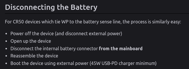

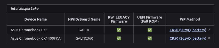

Where are the wp jumpers on the CX1400FKA (Galtic360)? Vid of mother boardhttps://drive.google.com/file/d/1Y4-rEbaQGfZoc_9ASG15LLiH0Hzj__RF/view?usp=drivesdk
I need help https://drive.google.com/file/d/1Y4-rEbaQGfZoc_9ASG15LLiH0Hzj__RF/view?usp=drivesdk
it’s almost like you didn’t read the docs
Hey thanks, yes I read the documents but it seems that I got the wrong model when reading them, I will try to do the battery method
I disconnected the battery and entered developer mode , still not working
Edit : I finally made It, thanks for your help , my problem was that you yabe to un plug the battery from the mother board , not just unplug the battery
they really should put that in the docs. oh, wait…

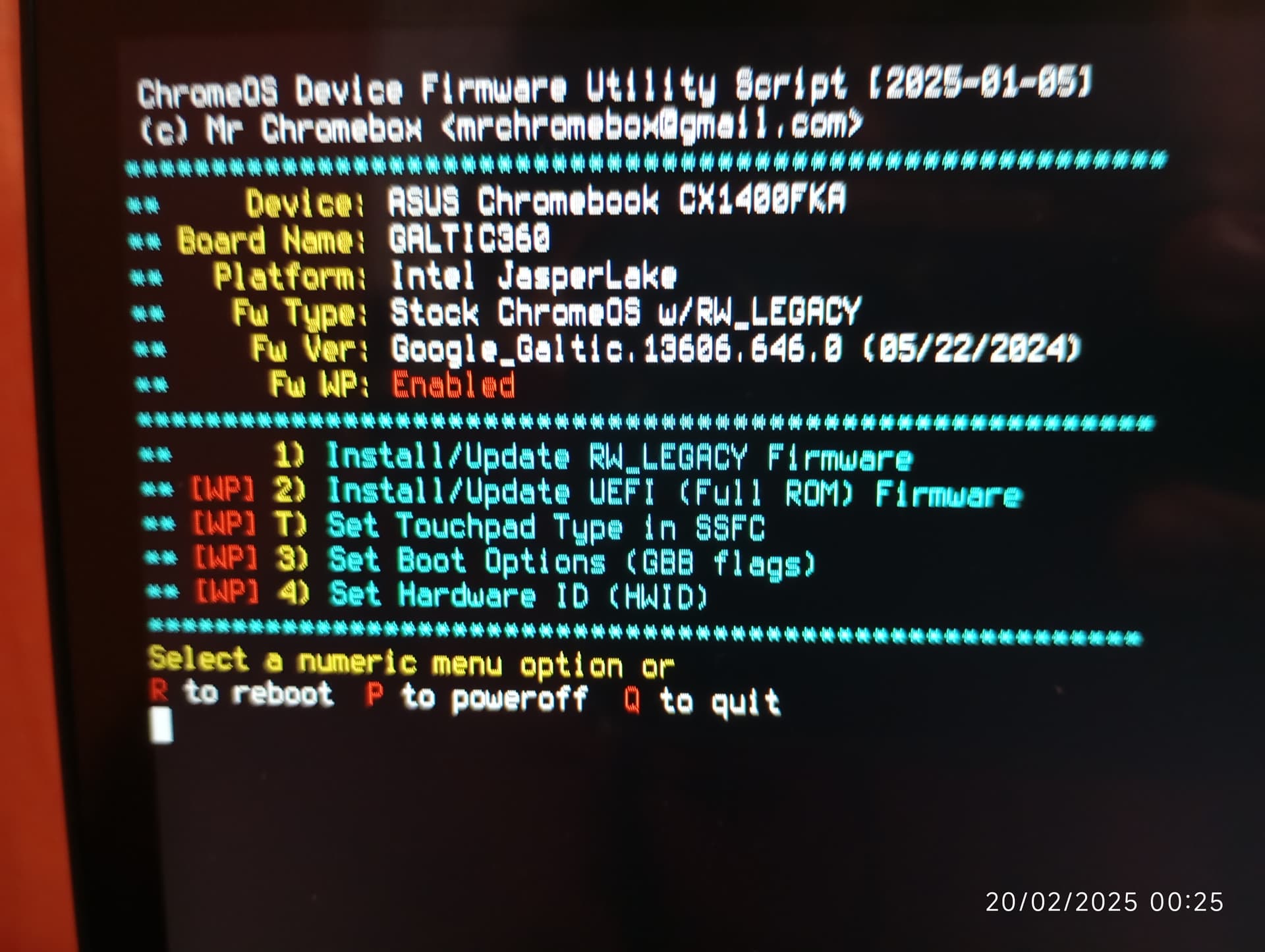

Hey thanks for the help , all works but the touch pad elen driver and the hid 12C , I tried installing It manually but not working and It gives me the problem 12 (not enough free resources at usage) and It tells me that i have to disable another of the devices of the device edit: I Saw the drivers resources and the HID 12C and Elan touch pad are using the exact same
And that looks like the issue (0x00000023 (36)
you need to boot a Linux live USB (ubuntu/mint/fedora) and run my firmware utility script, and use the function to set the touchpad type in SSFC. Then reboot back into windows and you won’t have the two touchpads both using the same resources
