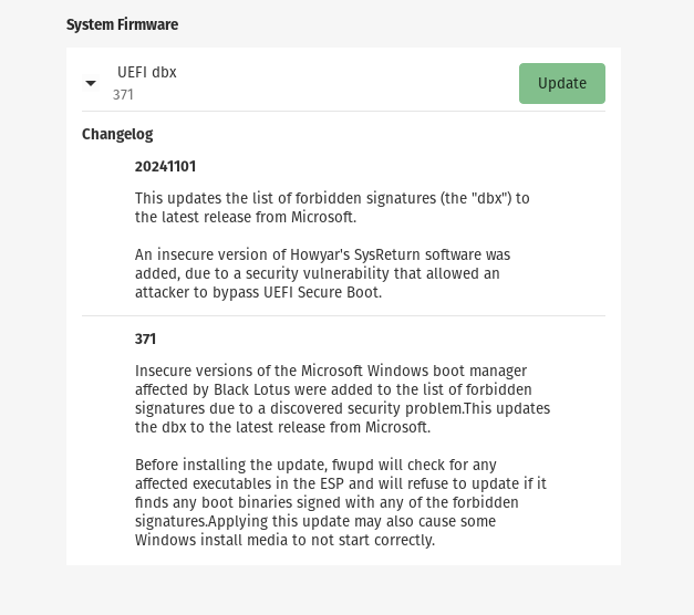

I recently received a prompt to update system firmware UEFI dbx, however I wonder if I should proceed as I originally flashed the firmware from MrChromebox guide and I would not wish to damage my system,
Would greatly appreciate any advice on whether to proceed or not, and if not, how would I disable the constant reminders?

the UEFI secureboot revocation database (DBX) is an updatable component of the UEFI firmware that tells secureboot what signed EFI executables not to trust anymore. It’s designed to be updated independently of the main firmware, but MrChromebox firmware does not support this feature at the current time. You can ignore for now and the next MrChromebox update will include an updated DBX.

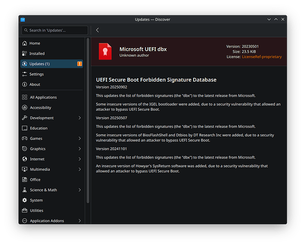

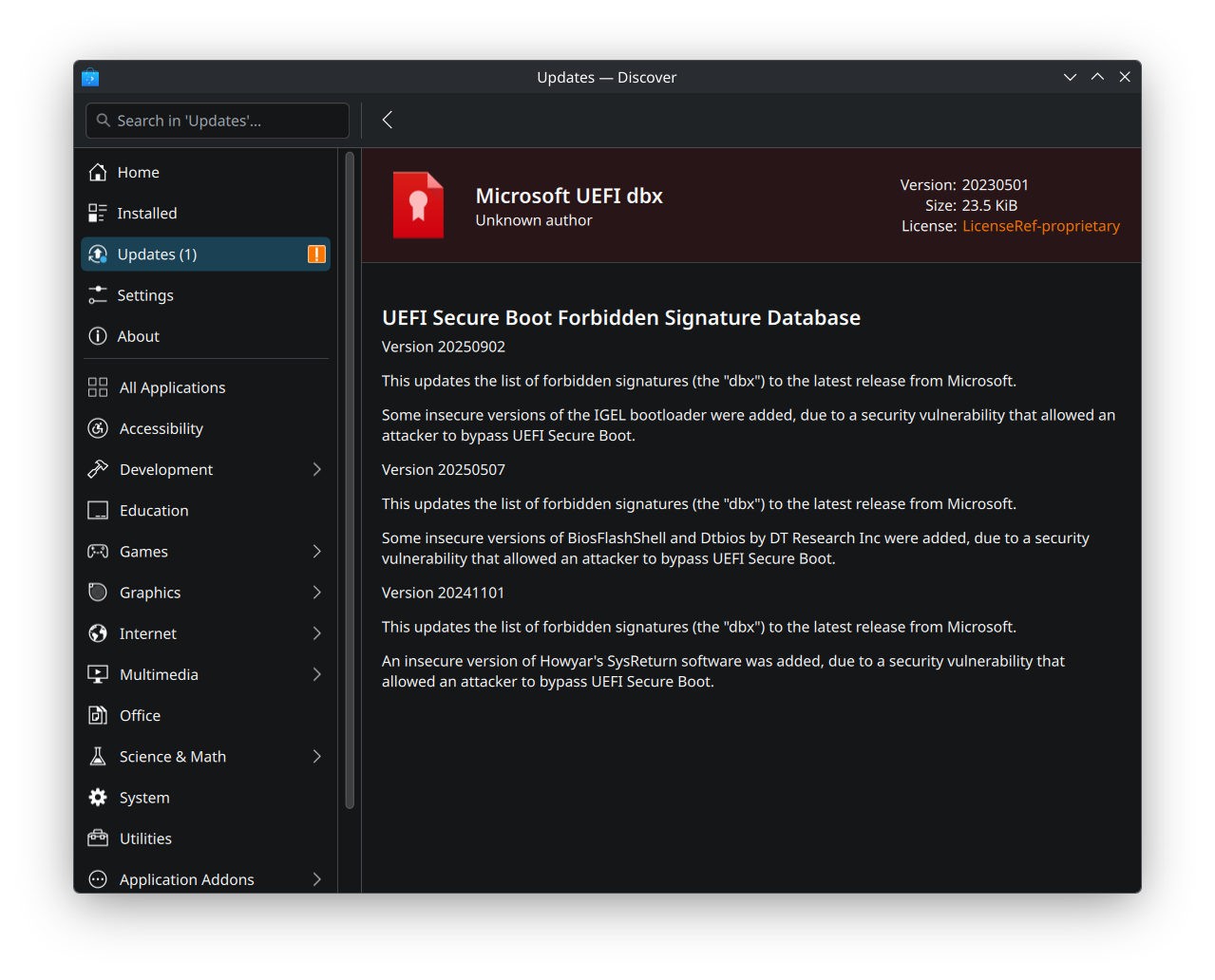

I have just received this update notification on Ultramarine 43 (Plasma variant). Presumably the move is still to ignore this update? Apparently the one that is installed right now dates to 2023. Am I right in assuming that it’s not a huge deal/an attacker would need to have local root access in order to take advantage of any whitelisted keys that they’ve gotten hold of?

The issue with the update failing to apply was fixed several revisions ago, you can apply the update and it will persist across OS changes
