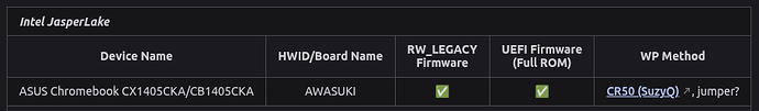

Hello, whenever I do the steps of the firmware of Mrchromebox, it just says the WP firmware is on when in my specific Chromebook I need to disable the battery and take it out. I didn’t find any videos or any guides about my specific Chromebook.
the whole reason we have documentation is so there is no guesswork when it comes to disabling WP
I did the battery without it plugged in and it doesn’t work, like the write protection is still on.
that’s not surprising, is it? The chart I posted above doesn’t list ‘battery’ as way to disable WP for your device. Because it’s not one.
Ah ok, so I need a cable on the docs above that mentions my laptop?
correct - a SuzyQ cable is currently the only known way to disable WP on your device.
Some other JSL boards have a jumper on the mainboard which can disable WP, and this one may too, but it is currently unknown (hence the ?)
