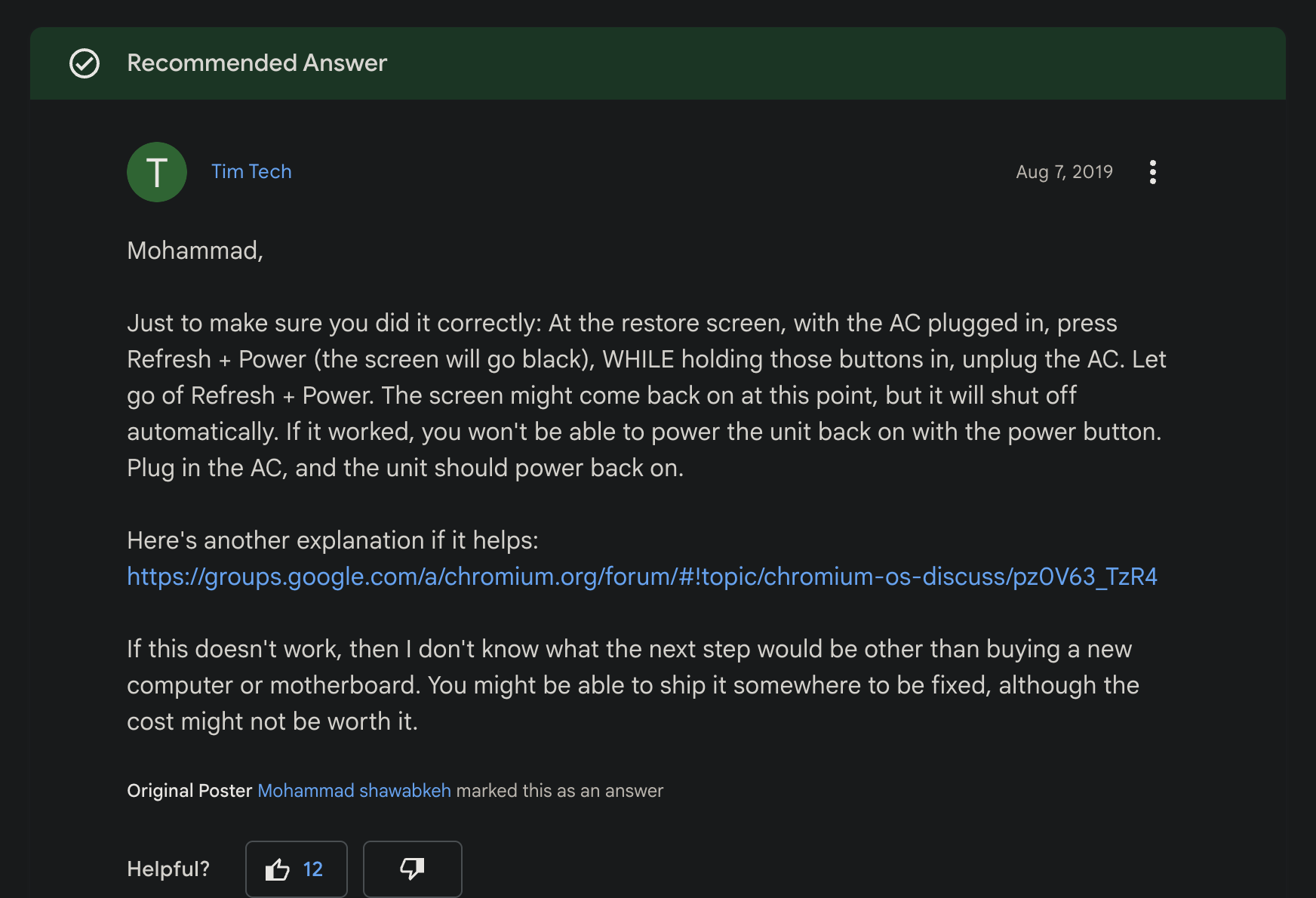

A quick google search and here is the solution I would take a look at
