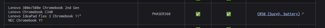

On that note, for Phaser360 system, could you confirm that I need a SuzyQable for removing the HW firmware lock or would removing battery and connecting via charger do the trick?
you could use something like opencore to patch the ACPI tables before booting Linux, but if you want to wipe ChromeOS and only run Linux, the Full ROM firmware is the way to go
as for WP, what does my website say? :slight_smile:
I was reading your website “cover-to-cover” (incredible job by the way and a token of appeciation is on its way :slight_smile:)…but I was confused whether battery removal and SuzyQable are interchangable.
so here, CR50 is the write protect mechanism, and SuzyQ and battery are the available methods to disable WP - either or, not both. so booting the device with the internal battery disconnected is sufficient.
