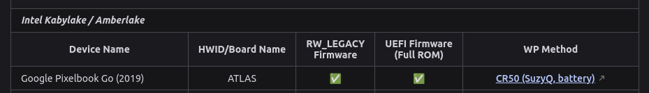

According to the chart here, you may need to disconnect your battery and then plug in power to make the system writeable.
Done, disconnecting the battery, is it possible btw to update coreboot after all? (ps. i got linux installed)
Yup, once you flash it the first time, you can reconnect the battery and update it using mrchomebox’s script
