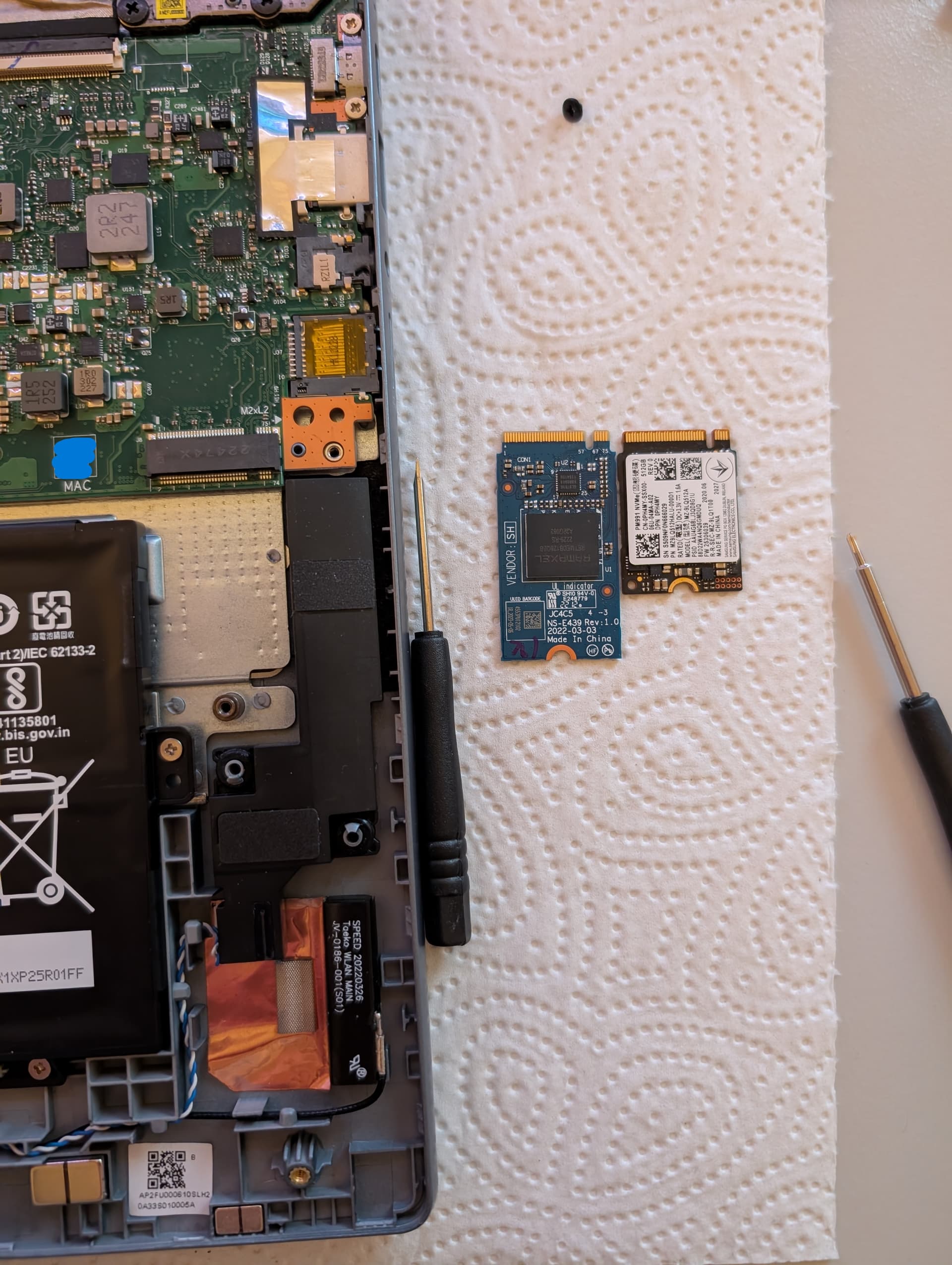

I just wanted to Report all Scripts worked fine on my Device. I successfully installed Ubuntu 25.04. The only thing to Change was the M.2 eMMc Card to a normal M.2 Device (bought a used one from a Steam Deck). All worked out of the Box, Audio with that Script, as it was Documented.

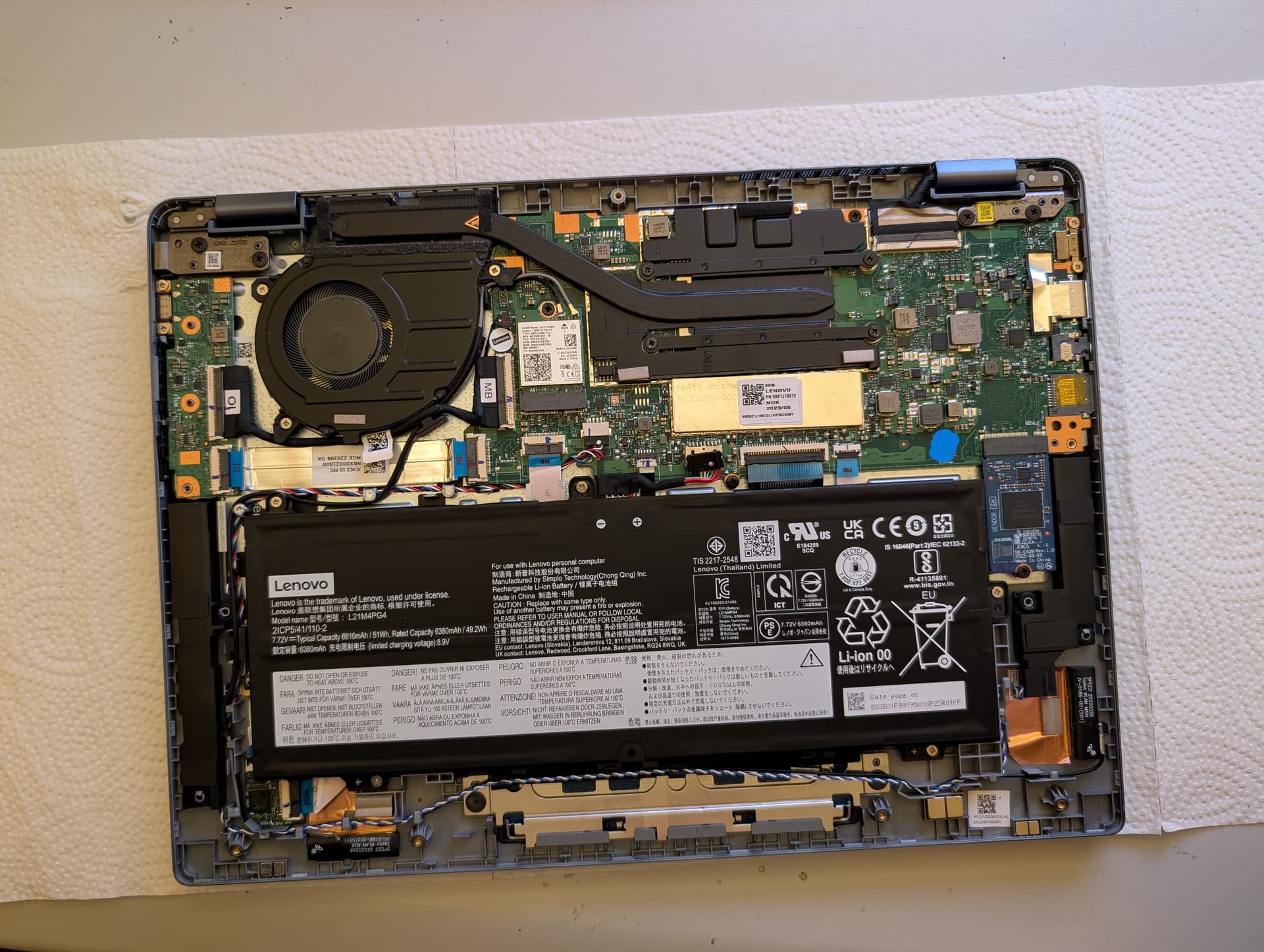

Some Pictures, to see the insides of the Device, are Attached.
Maybe ask me for assistance on the Same Device, or if you need more or a special Picture.
