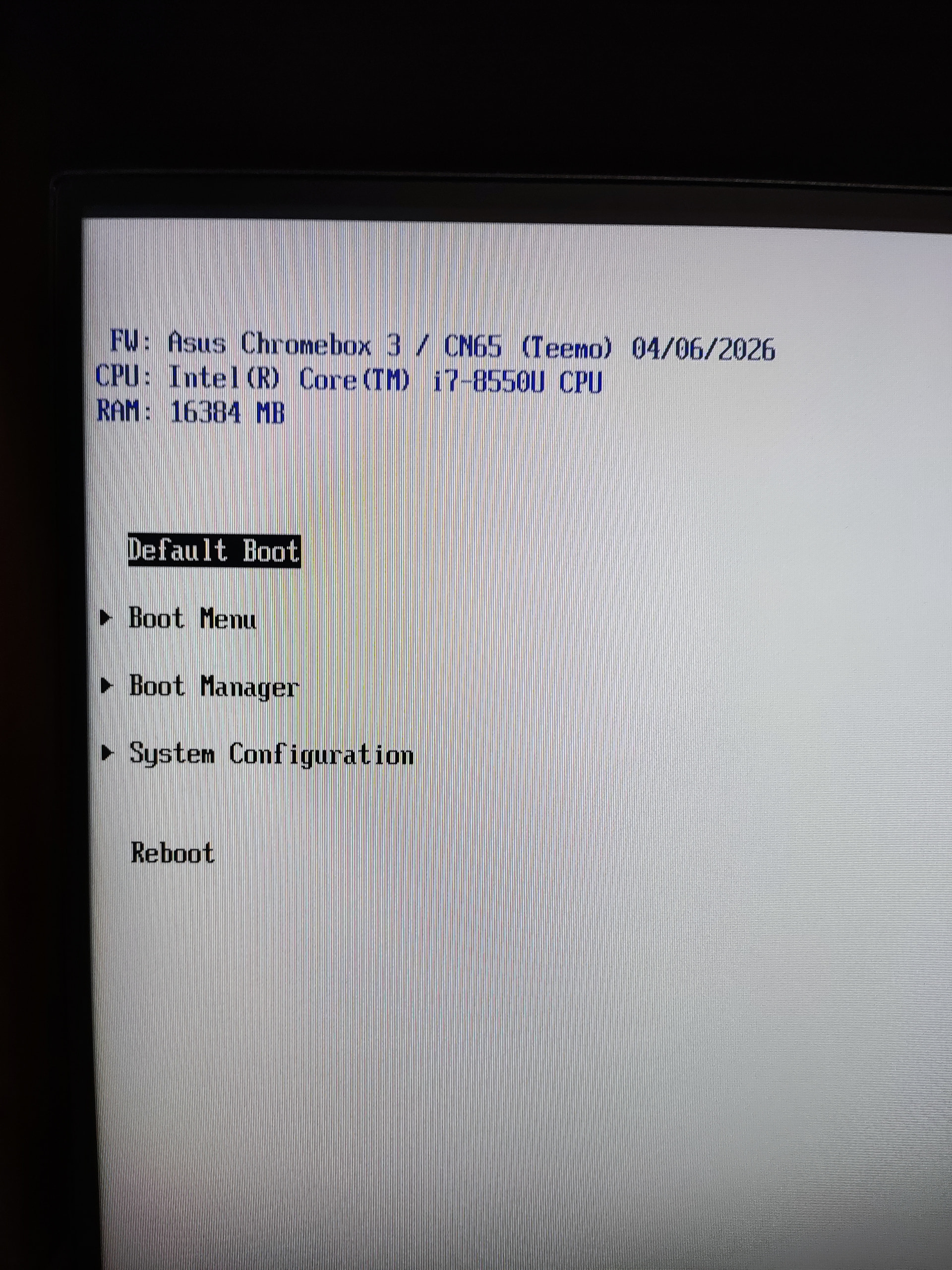

“cd coreboot↲
./build-uefi.sh fizz↲”
That’s the command as usual. It worked well on 04/06/2026(firmware date). On 04/10 I found the repo updated 10 hours ago. I used “git pull” command and it didn’t work any more.
you’ve clearly made changes to edk2 based on the image posted. clear the edk2 repo and do a clean build.
