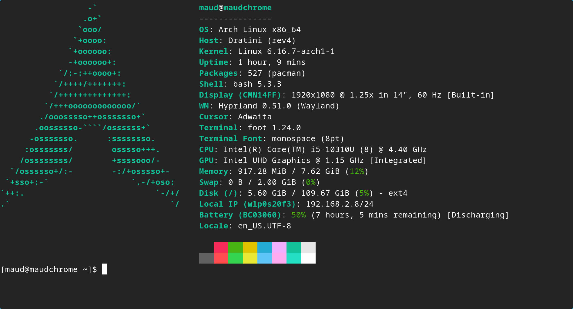

welp I got around to doing it and successfully upgraded my eMMC from 64gb to 128gb
got some larger eMMC chips from the same product series and tadaa

Your posts here inspired me to attempt the same upgrade on my own chromebook (same model as yours) and I succeeded with a 256gb Samsung emmc, so I can confirm that any emmc 5.1 compatible chip with the same speed and voltage rating should work.
