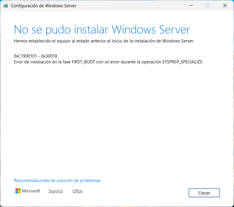

Windows 11 25H2 has been there for a while, and I wanted to update my Windows 11 24H2 installation.

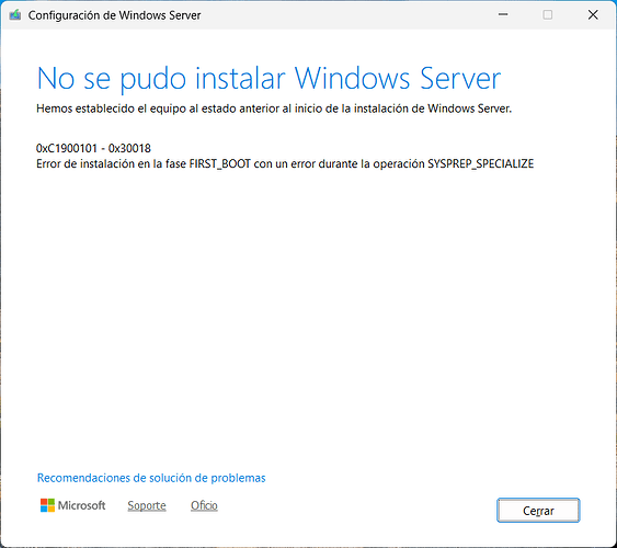

With the second restart at 46% it blue screens with WDF Violation and undoes the installation. And then I get a window of Windows 11 installation program saying that had an error in phase FIRST_BOOT error operation sysprep_specialize. I’ve already tried sfc /SCANNOW and DISM /Online /Cleanup-Image /RestoreHealth and still doesn’t work.
The Chromebook that this operation is being made is an Acer Chromebook 314 CB314-1H.
Thanks for the help.
(Do not mind about the word “Server”, it’s just a trick that worked on other unsupported PCs)
Ok, so the solution for those cases, would be uninstalling all the drivers (fun fact I have like 2 to 3 times the same driver for each thing). Now it’s finishing, let’s see if the drivers can be installed again (I hope so).
I could reinstall all the drivers, all is fine. thanks anyway
