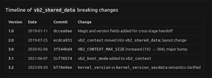

vboot shares a work buffer between RO and RW. RO fills it with a vb2_shared_data struct during verification. That struct has:
  • Magic and version (major/minor)
  • Offsets (e.g. data_key_offset, preamble_offset, hash_offset) into the same buffer
When RW starts, it runs vb2api_reinit() on this buffer. That function enforces:
  1. Magic must match
  2. Version must match: same major, and minor must be ≥ RO’s minor
So RW’s vboot code must expect exactly the same struct layout and version that RO produced. If RO and RW are built from different branches or commits, they’ll have different VB2_SHARED_DATA_VERSION_* constants and/or struct layout. Then RW either fails reinit or misreads the offsets and corrupts verification. That’s why RO and RW must come from the same codebase.
This means that if RO is actually RO, that RW can only be updated so far as there are no changes in the vboot shared data or major/minor versions.
make sense?

Yet I think it’s still not enough information, as I cannot follow your statement that even different branches or commits do change those values. As far as I understand VB2_SHARED_DATA_MAGIC it is not a magic in the sense of for example Linux’ module vermagic, to have a value which differs with every build. It seems to be a fixed constant at the beginning of the struct to detect if the memory at hand is the correct struct type or something was corrupted. The magic seems not to have change since the beginning. Seems to be completely unrelated to this topic.
And the major and minor version numbers here seem not to cohere to coreboot versions. Even completely different coreboot versions may have the same versions for VB2_SHARED_DATA_VERSION_MAJOR/MINOR numbers at least if the layout of the struct did not change, for example because the vboot implementation remains the same or is compatible to each other. Both seem to be change quite seldom. Even the minor version seems to be the same for several years now.
Having coreboot updates of many kinds with ro-sections, even from different code bases, seems to be quite possible at least.
As you are an experienced developer and I don’t think you are mistaking this and I am new to the topic, I think that I do misinterpret this here. Yet I’d like to understand what my misunderstanding is, so please don’t beat me for still asking in this topic. :slight_smile:
saying “it doesn’t change very often” doesn’t negate the fact that it does change, and that adding code to deal with handoffs between differing RO-RW struct versions gets very messy very quickly. It also means that future changes have to be evaluated with the context of how they might break older RO handoffs – something that the vboot project (which is separate from coreboot) has not committed to doing.
This is the exact reason why Google has firmware branches for every device/platform, and why you only see select backports/security fixes to them, rather than using a rolling release based on coreboot main.
4 changes in 6 years, one within the last 4.5 years, does not explain branches for every device/platform. That doesn’t explain per device branches.
