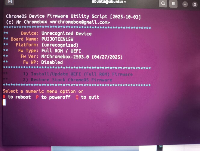

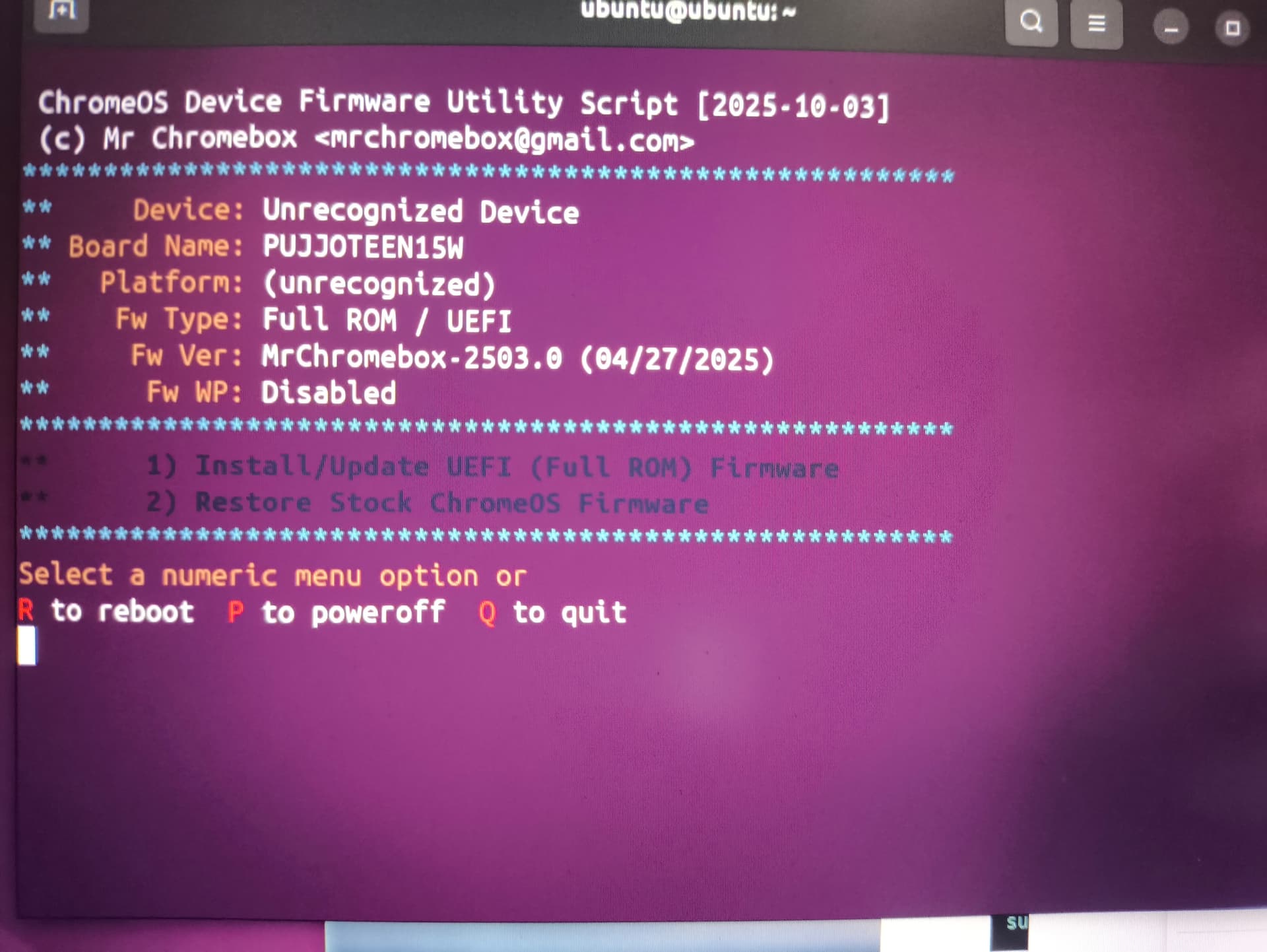

Hi @MrChromebox today tried update my chromebook and your script show not recognized device, attach picture.

looks like there’s a few devices that the new database lookup isn’t working for

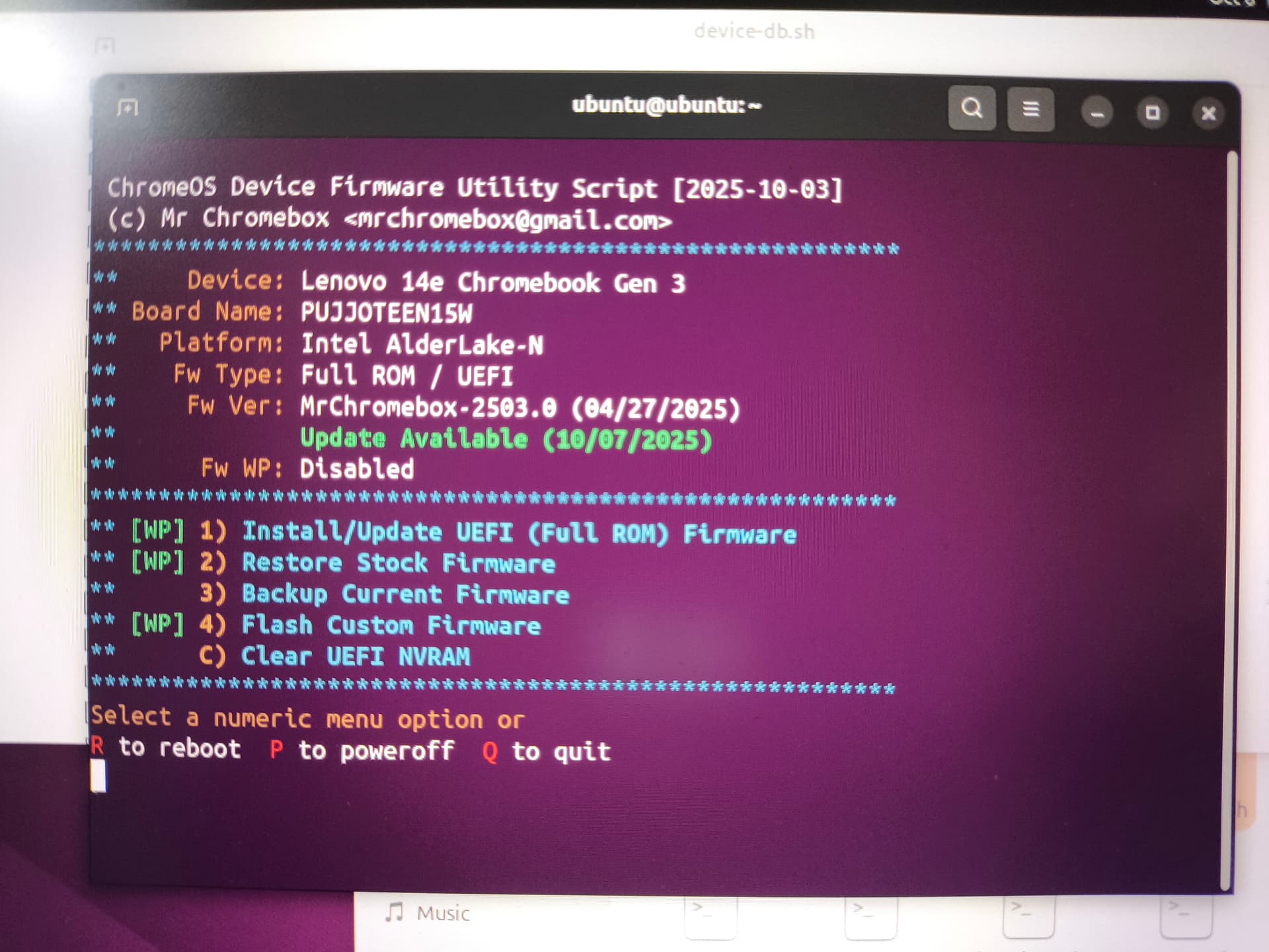

Seems that the name in device-db.sh have extra “()” tried edit from PUJJOTEEN(15W)-KCBW or PUJJOTEEN(15W)-CZPM to PUJJOTEEN15W and the script says update available (still not try flash).
