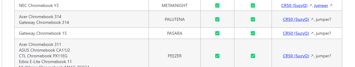

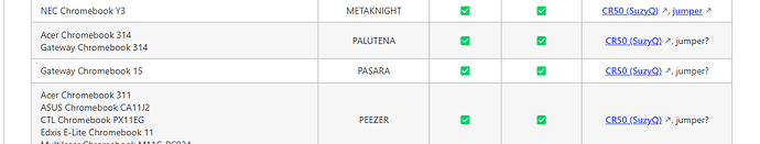

I am looking at the “supported devices” page to check for my device which is the Pasara - Gateway 15. On the right it says CR50 (SuzyQ). Do I need to unplug the battery as well as use the SuzyQ cable to disable WP? I don’t want to brick anything and thats why I’m asking.

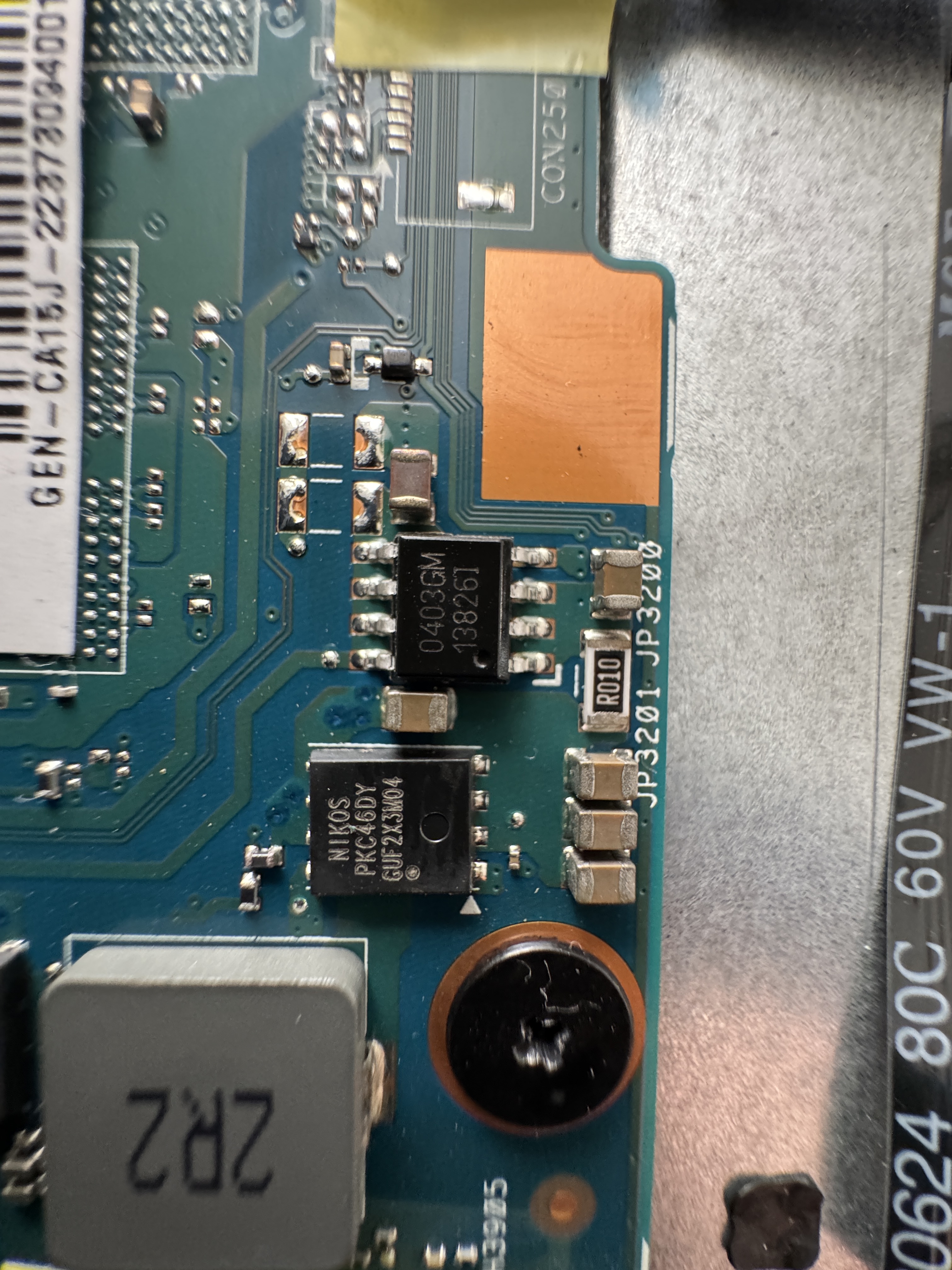

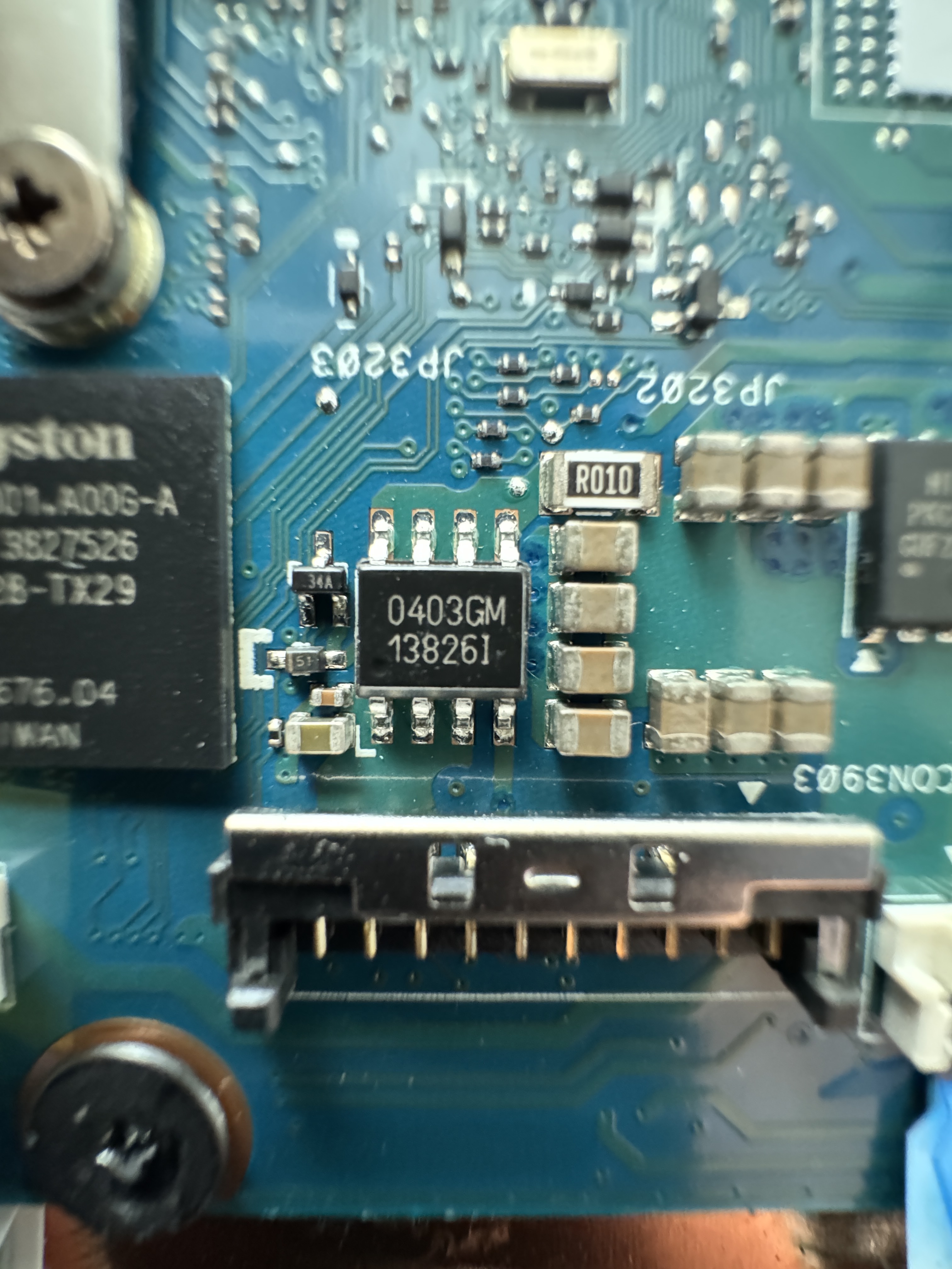

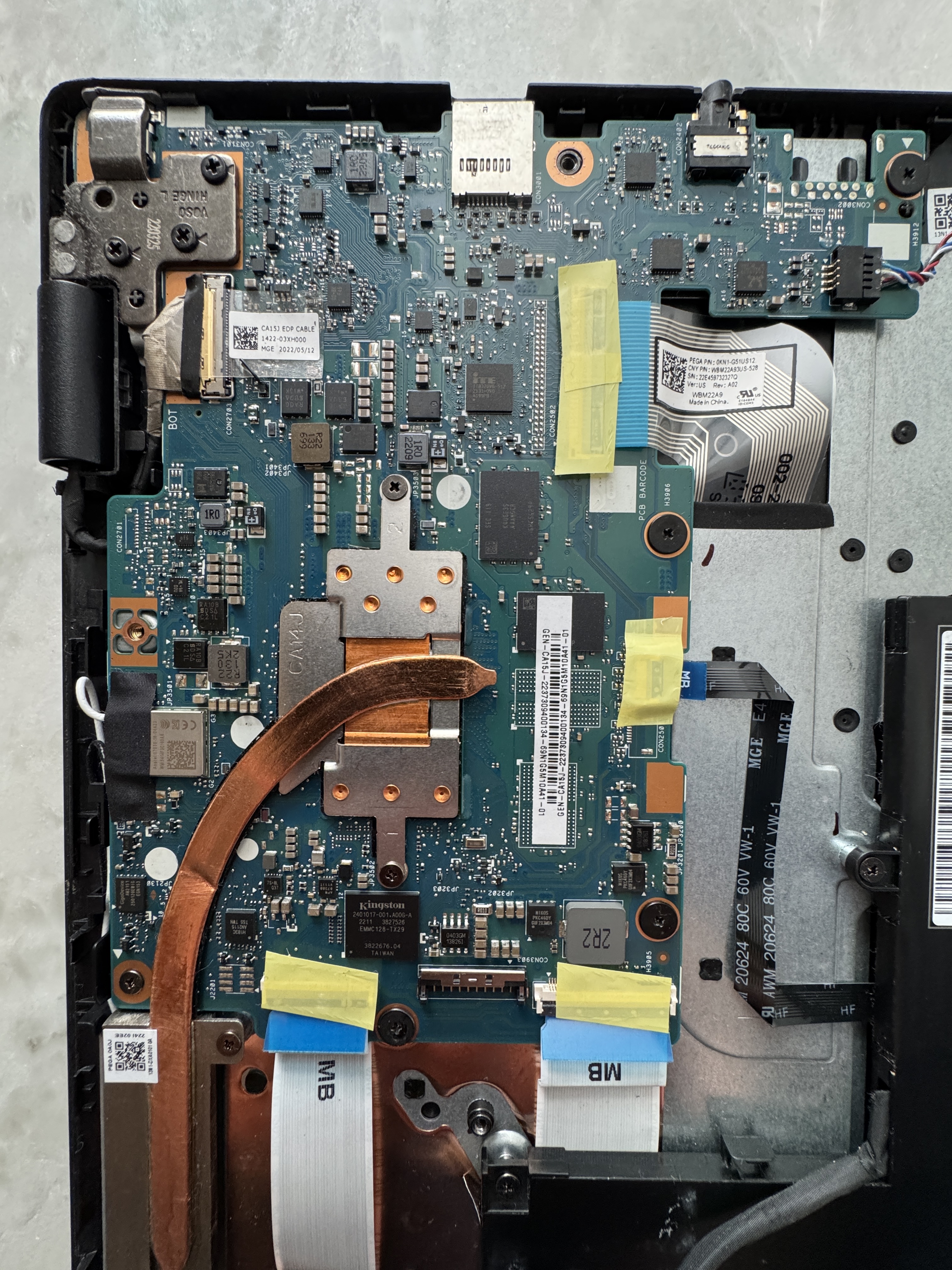

Also, how do I know which chip to plug onto? I will add pics of the chips I believe are it.
no, you follow the directions for disabling WP via SuzyQ.
The SuzyQ cable is a USB cable, it does not connect to any chip on the mainboard.

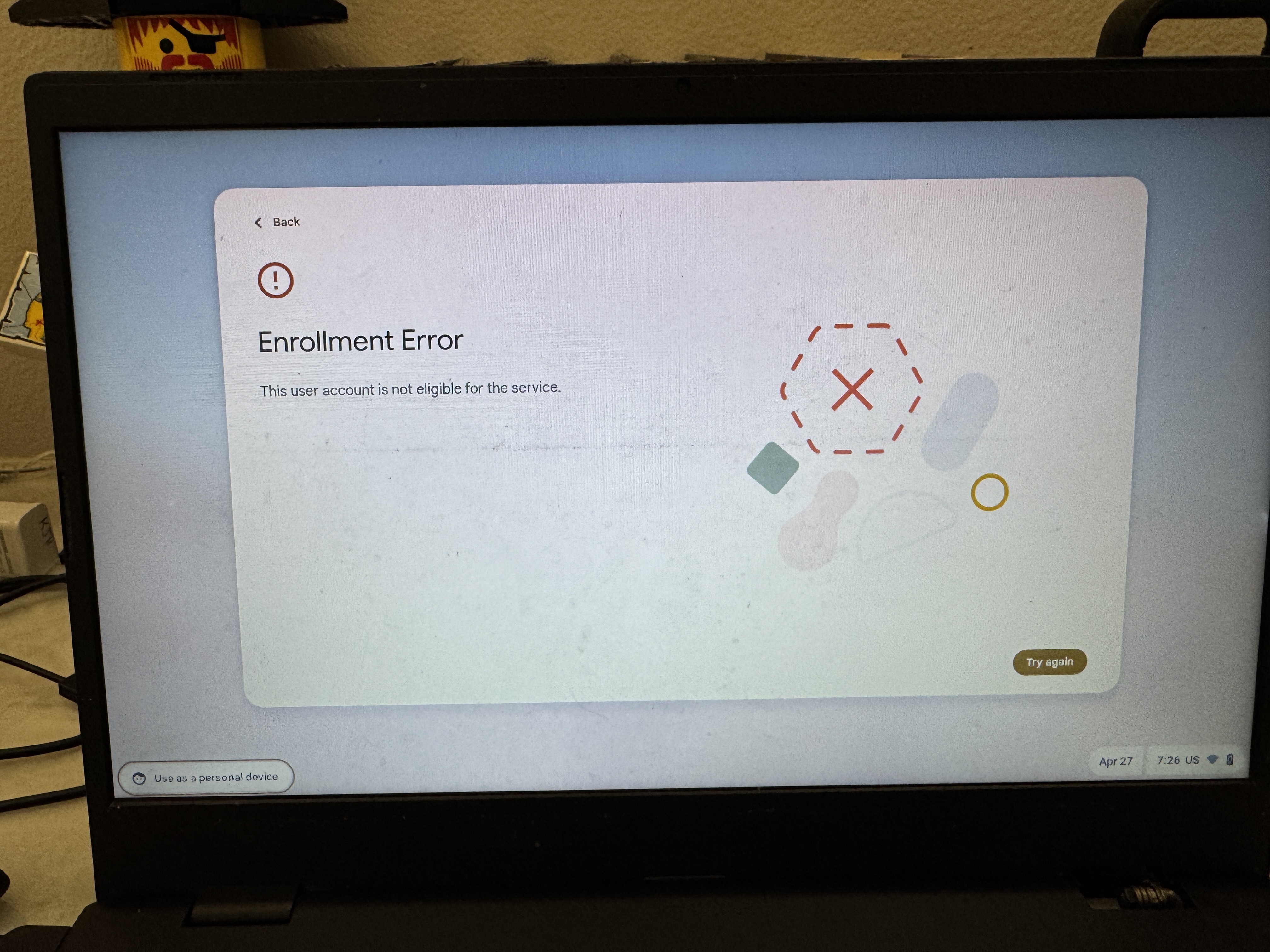

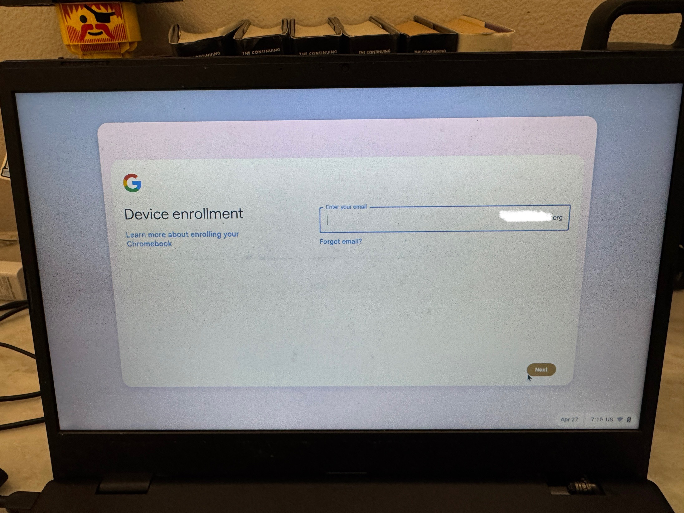

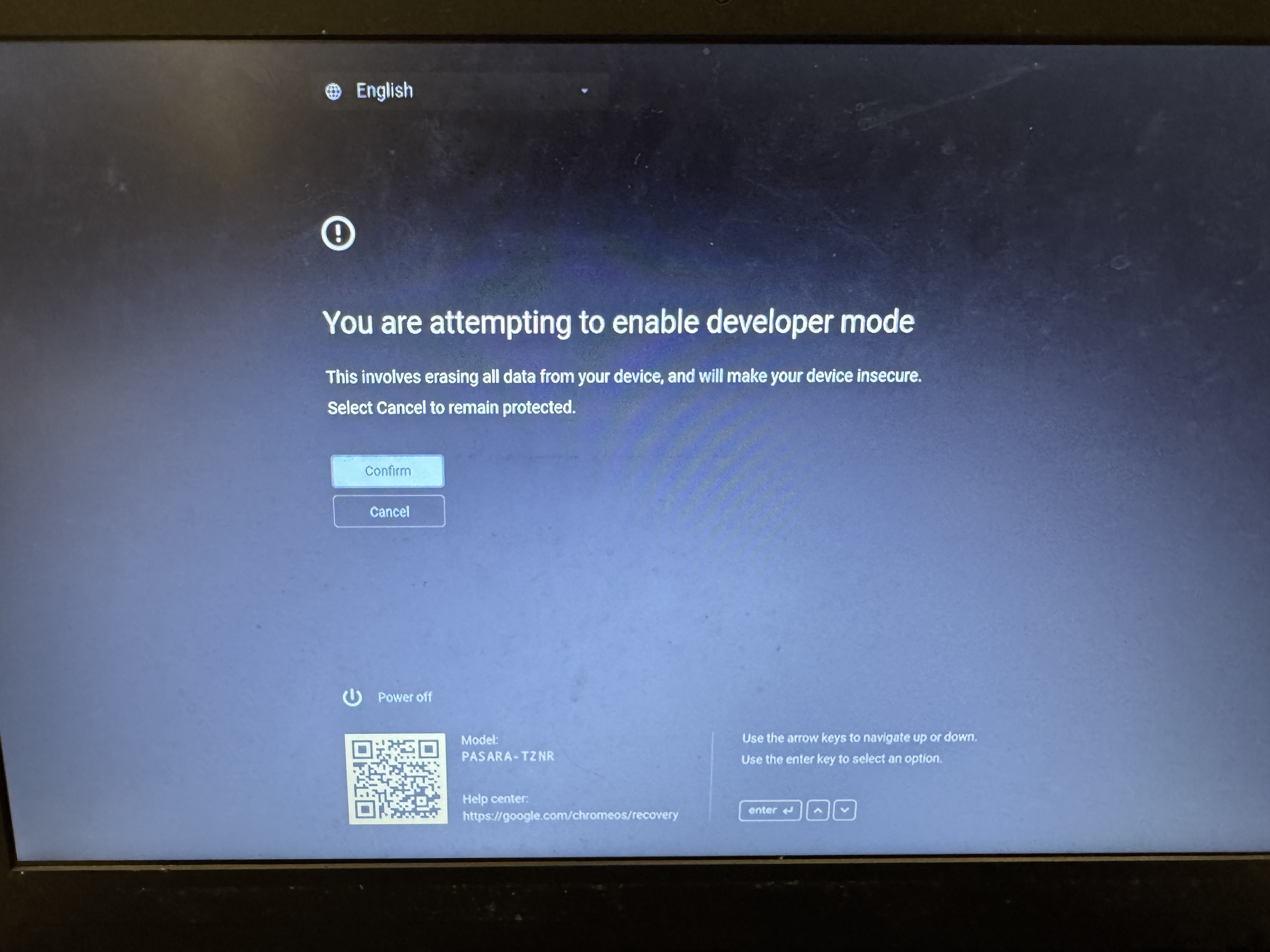

I’m just worried I cannot follow them because I cannot get into DEV mode.

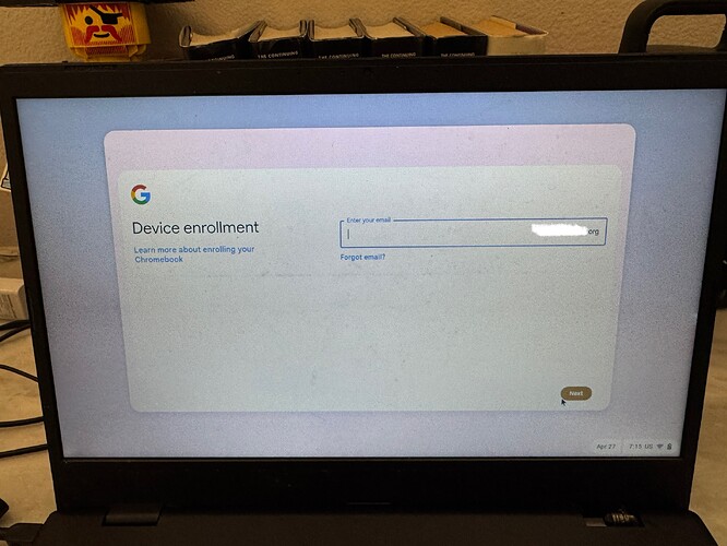

well that’s a completely separate issue. is your device enrolled?
No, how do I do that?
I cannot get past this.
if you don’t understand what you’re doing, then you need to go and read the documentation, then come back and ask specific questions
This board is identical to GALLOP - my guess would be that this uses the battery for WP
