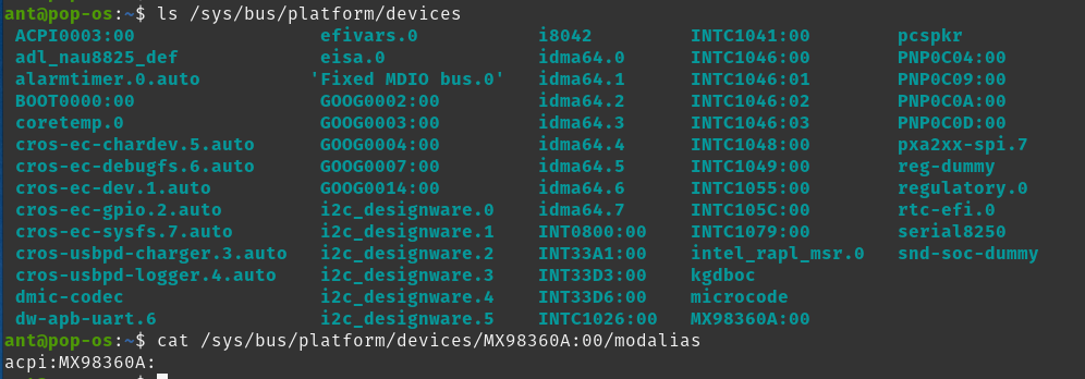

Looks similar. But I cannot get both speaker and headphone to work with the script. Any advise?
