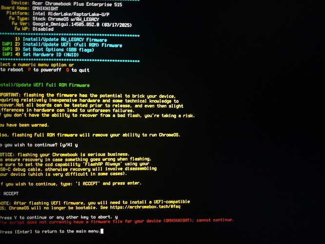

What’s weird to me is it will allow me to use the first one, (For duel booting), But not the FULL ROM one.
why is this “weird”? The RW_LEGACY firmware is the same file for all boards in a given platform/baseboard. The Full ROM file is specific to each board.
The script doesn’t currently have a Full ROM file for OMNIKNIGHT.

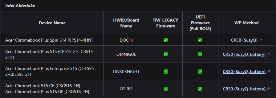

It’s just weird to me that its seemingly says it’s supported for both ways. I don’t know if I accidentally did it wrong or something though.
it simply means I forgot to generate the file or am missing a config for it, I’ll try and sort it out tomorrow
I’ve added an image for OMNIKNIGHT, but it’s untested, and so I would not recommend flashing without the ability to unbrick/debug if needed
