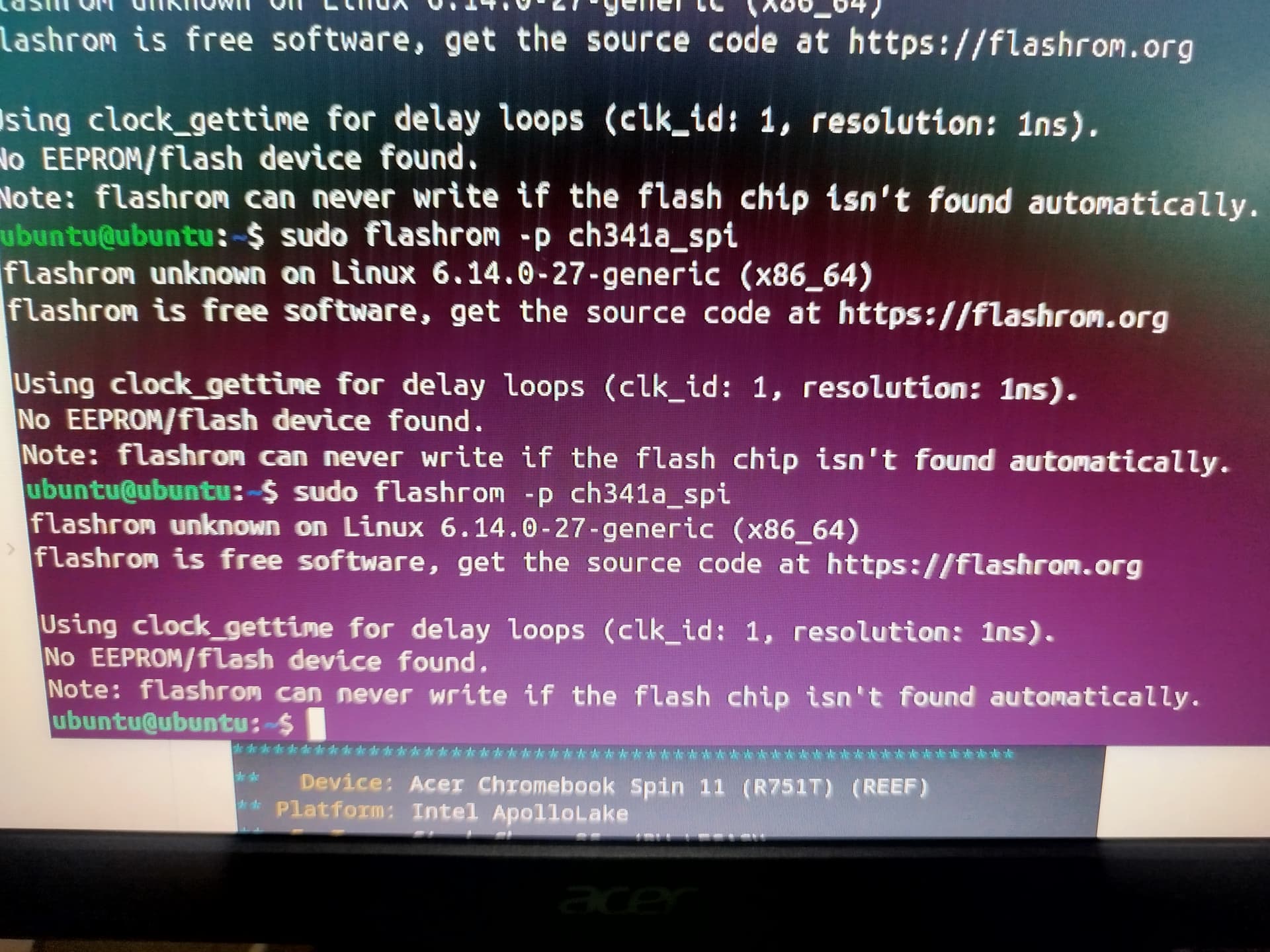

found a chip name giga device HJ2104 25Q127CWIG and Windbond 25Q80VDVIG

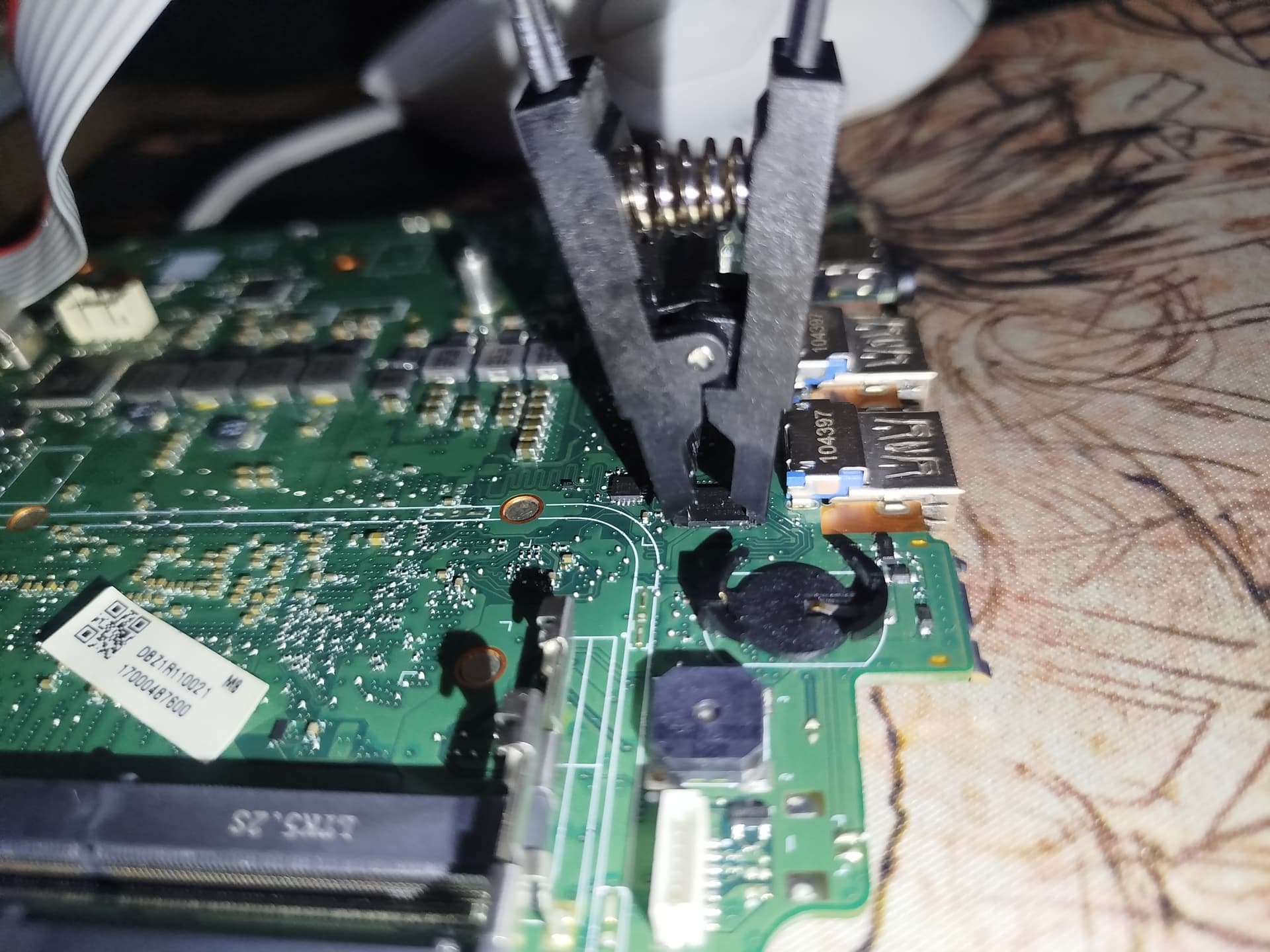

and the next problem is i cant clamp on to those 2 idk why

im trying to flash that chip i cant clamp into it the solder is tiny

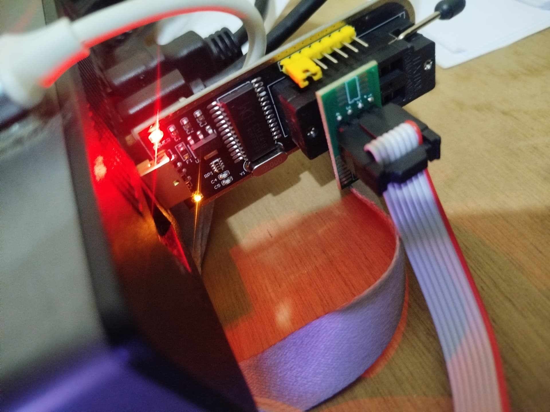

is it normal that the run led is not on?
You have two options; solder cables or change the EEPROM of WSON to TSOP type
the run led is not on rn
IDK WHY IT IS NOT WORKINGGGGGGG IM TRYING TO MAKE THIS WORK FOR 4 HOURS
chip clip not making good contact is the most likely scenario
not sure how it takes 4hrs to get to this point
That looks like a WSON flash chip
the chip and the solder points are so tiny that they cant even grip on it
as per above, it’s a WSON-8 chip, it’s not clippable
so ch431a clip is useless?
the ch341a is fine, a chip-clip for a SOIC-8 chip will not work. You’ll need a 6x5 or 8x6 pogo-pin probe, depending on the chip on your board
i have wson8 to dip8 but i have no heatgun and no experience in soldering and the probe cost 500 in my country so
