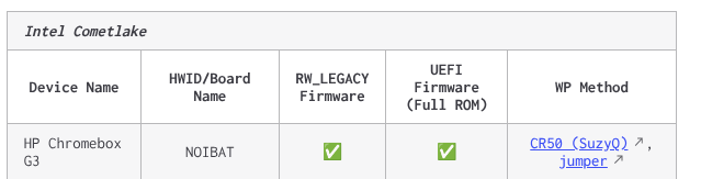

I cant acsess dev mode but i have an rasspery pi 4 to use as an external programmer. What are the thinks i need to know? And where do i download file to flash. Its an ho chromebook g3 btw

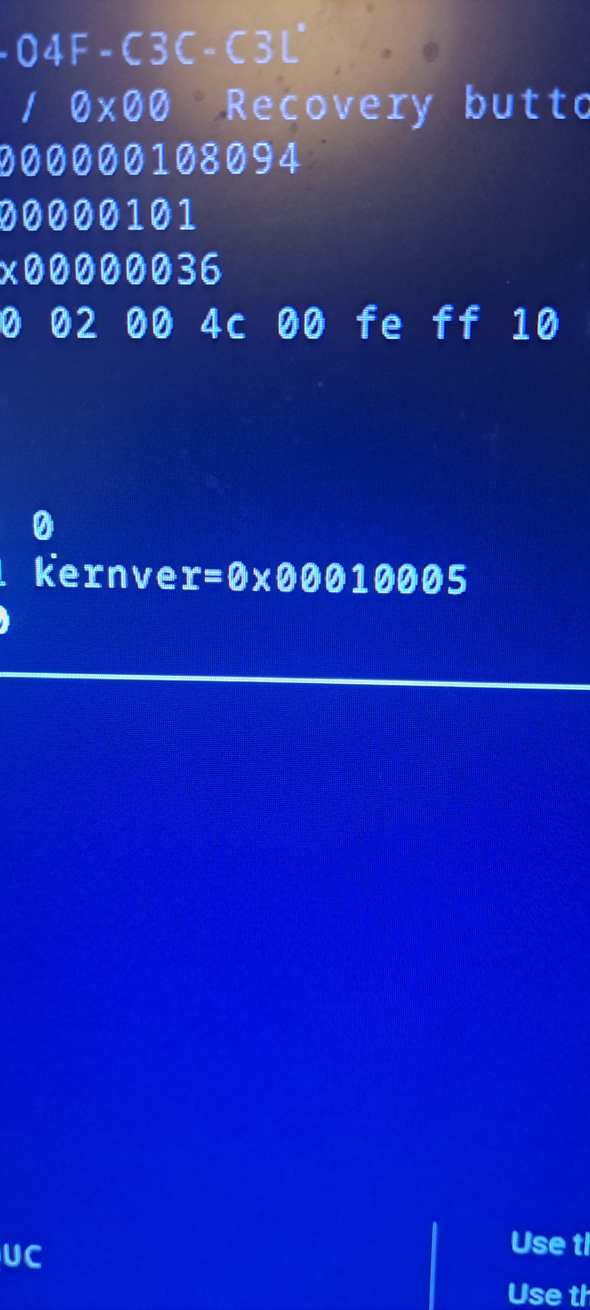

Find "kernver’ and determine what version it is by looking at the last number of the string.
(ex: kernver=0x00010005)

Go to recovery then press tab..
What’s the kenver or hell. Just post a screenshot
sorry for late posting
Can you screenshot the whole recovery screen
Alright, perfect!

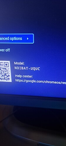

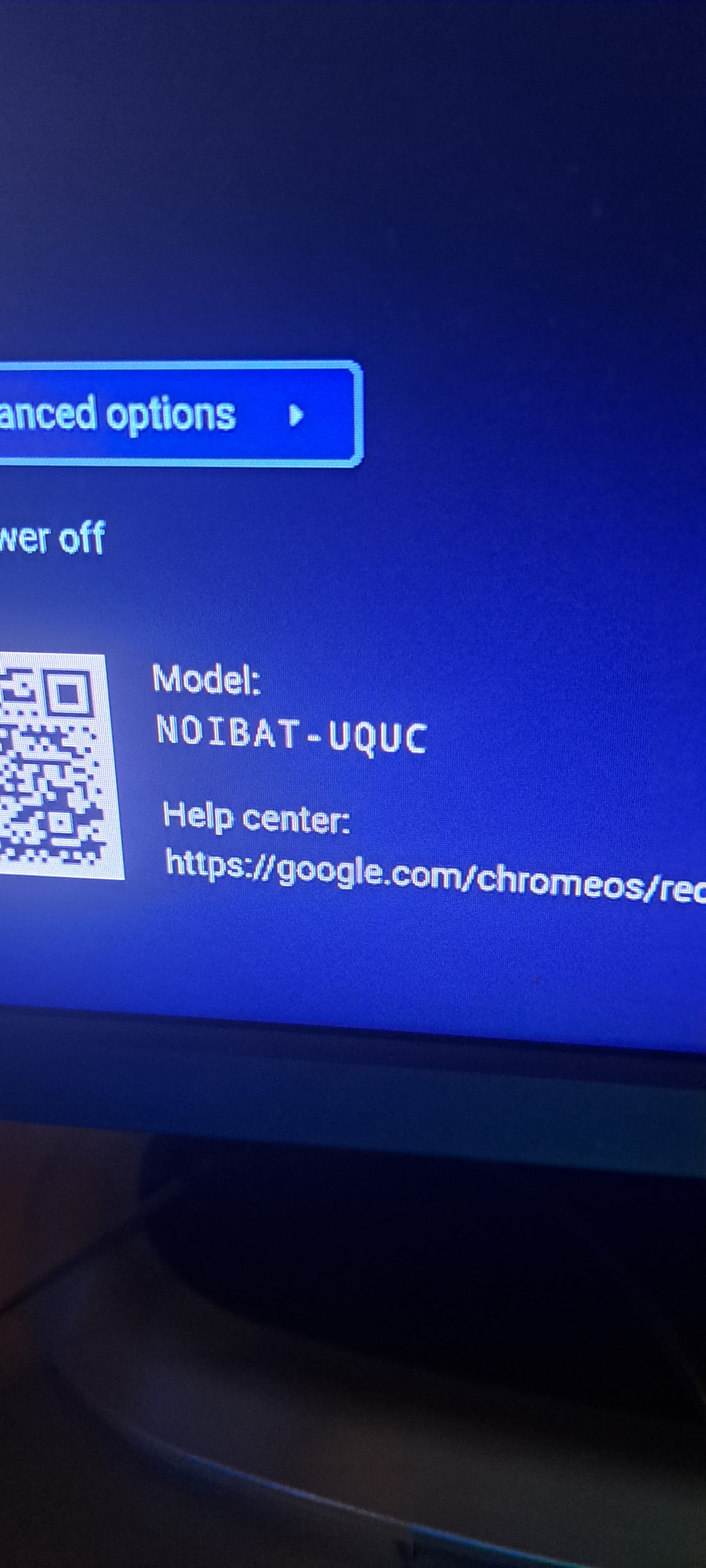

i cant see what model i have?
