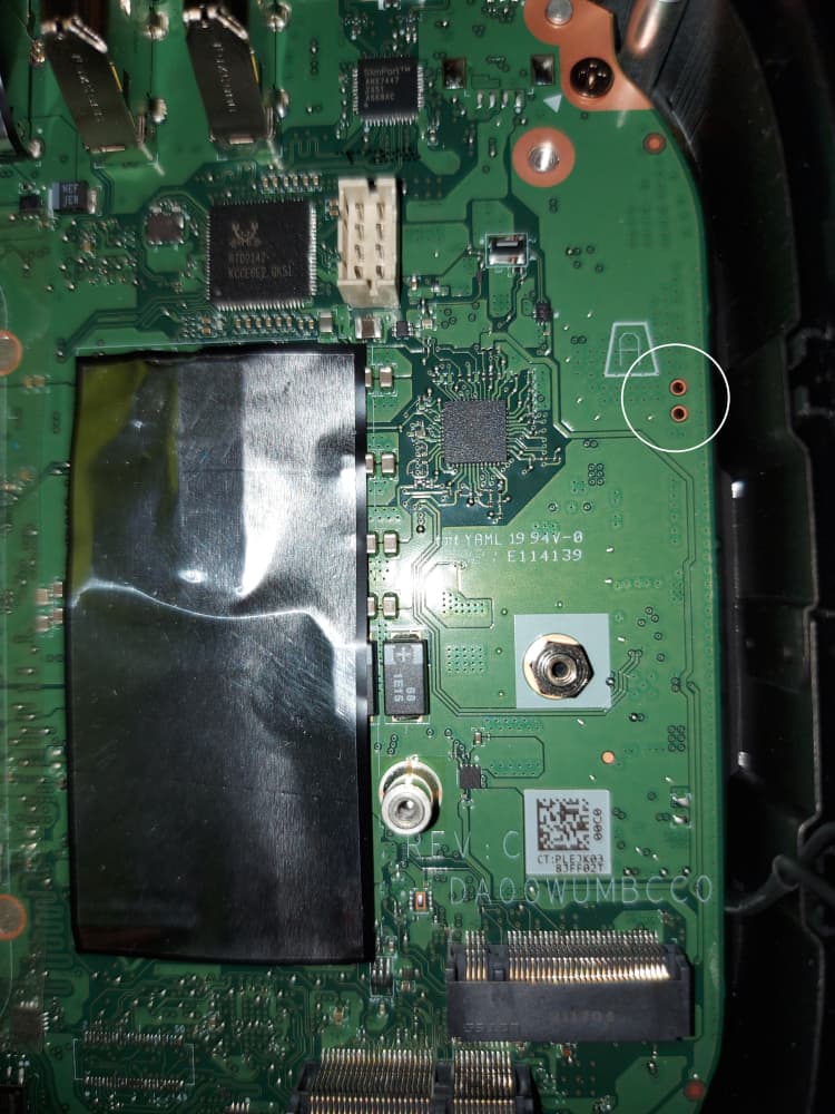

I recently bought HP Chromebox G3, just for a small server.
I can’t find where jumper suppose to go.
Hopefully @MrChromebox or OP can guide me through picture.
Plus, do jumper needs to be permanent?
there’s a picture on my site
the instructions say you can remove it after flashing. But if you use a solder bridge to connect, no need to remove it.
Thanks a lot, I will try this today and report the progress back.
I searched multiple times on the website but could not find the picture or instruction for this device.
Thanks again. Have a nice time.
searched how? it’s on the supported devices page, there’s a link to the pic. The WP method is listed along with a link on how to disable.
I did not click the jumper link in the supported device list. Skill issue I guess. :face_with_hand_over_mouth:
