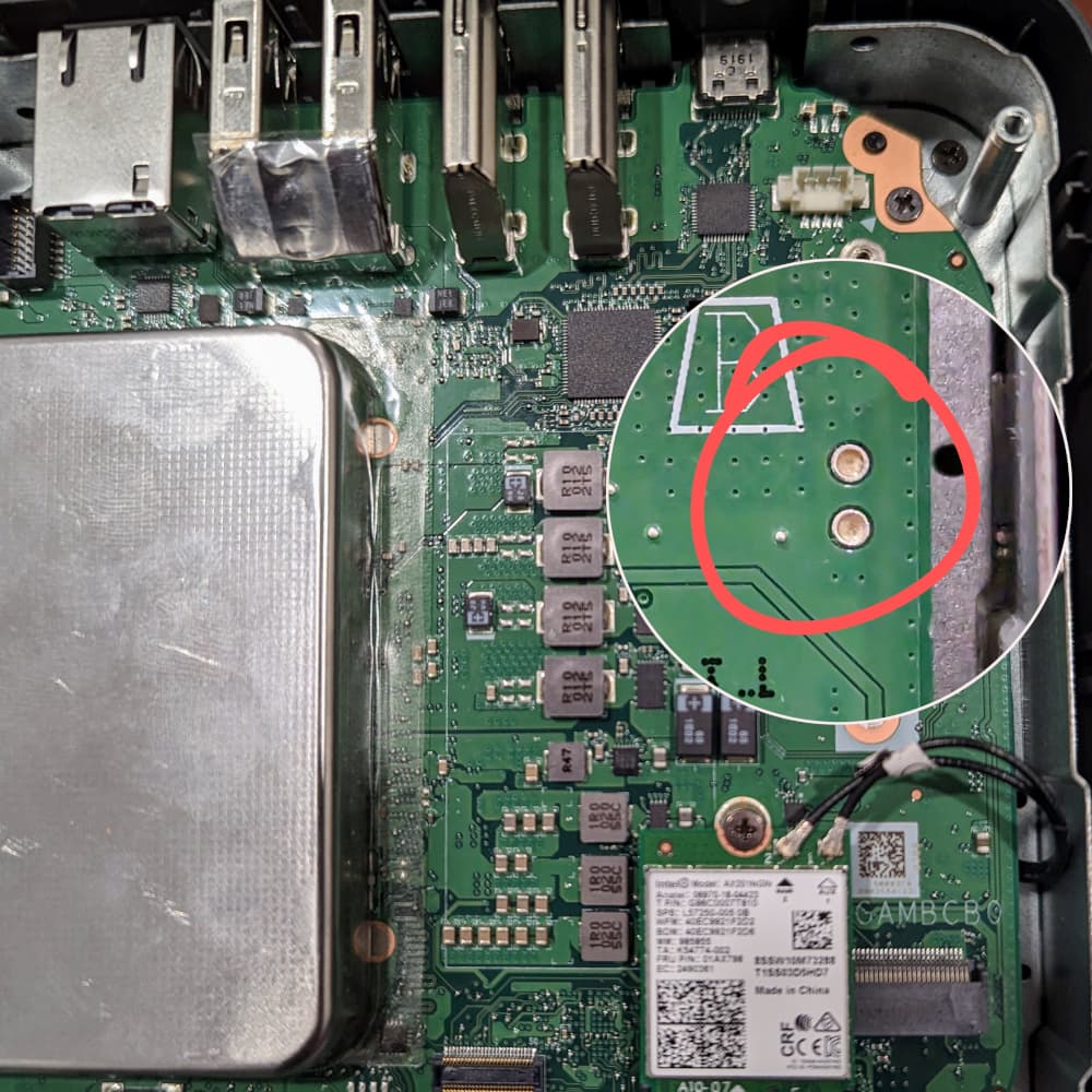

the jumper is under the SSD, you have to remove it to access.

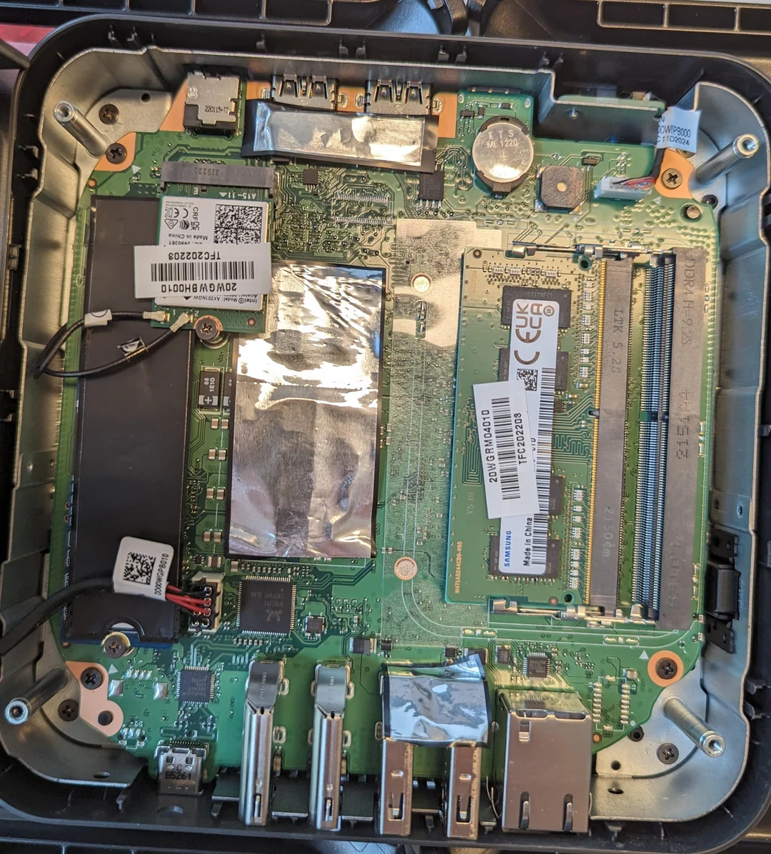

Mine looks like this:

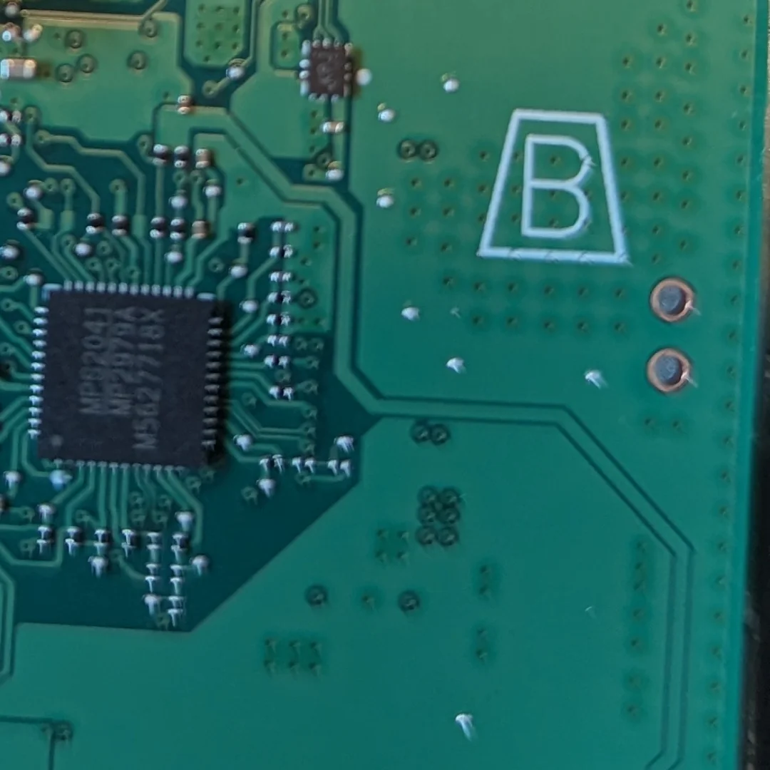

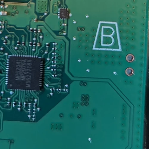

Sorry for the little blurry photo. The soldering holes are not filled on my board. I tried different options to “connect” the pin-holes using paperclips, metal tweezers and such, but it doesn’t seem to have worked, as WP is still enabled… any better ideas how to connect em? The the electric line of these soldering holes should be the small golden circles around (but not in) the holes, which is legit for soldering, but makes connecting them a little harder.
Maybe also WHEN exactly does it need to be set/connected? Tried it turned on and turned off. During boot or something maybe?
as you noted, the connectivity is on the rings of the holes. A paperclip will work if large enough to make contact. Filling with solder and running a bit across to bridge them would be the most reliable way (and what I did on my JSL chromebook). This should be done with the device off and power disconnected (obviously).

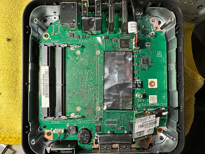

I have same Wyvern and I ve done ten other Chromebooks but this one has me stumped too. I have under the SSD an empty screw hole but normally it will say WP , this says nothing. When I download the mrchromebook SW the 4 choices 2 3 +3 have that WP highlighted. Tried without battery and few other things No Joy. Any suggestions Thanks in advance. CTL Chromebox * Intel® i7-10610U Processor
  • 64GB DDr4 RAM
  • 2TB M.2 Storage Wants to install Windows as the specs here are wasted on Chrome
BTW Option 1 in Menus of 4 is not WP .
Option 2 UEFI is WP 3 + 4 as well.
Can I use 1 Legacy to install Windows Ubuntu or Flex?

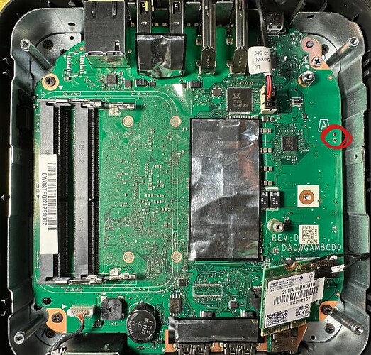

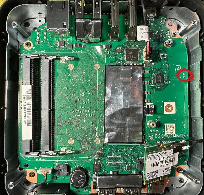

I don’t understand how the pic/instructions are unclear for Wyvern. There is a jumper pair, not a screw hole, under the SSD. It’s circled in the pic. You connect them with a bit of solder.
You cannot install Windows or Flex with RW_LEGACY and have it actually work.

I dont have that two hole strap I have One empty hole same spot under SSD but no screw there and no WP marking.
I really want to Win 11 or Ubuntu or if I want to go back its easier to Boot Flex from that USB. I just cant UEFI choice # 2 as it say WP there. Choice 1 Legacy is the only opened option at this point.
post a pic, neither of my two Wyverns looks like what you are describing
no, it’s easiest to boot a ChromeOS recovery USB from recovery mode. Flex makes zero sense on a device with ChromeOS support.

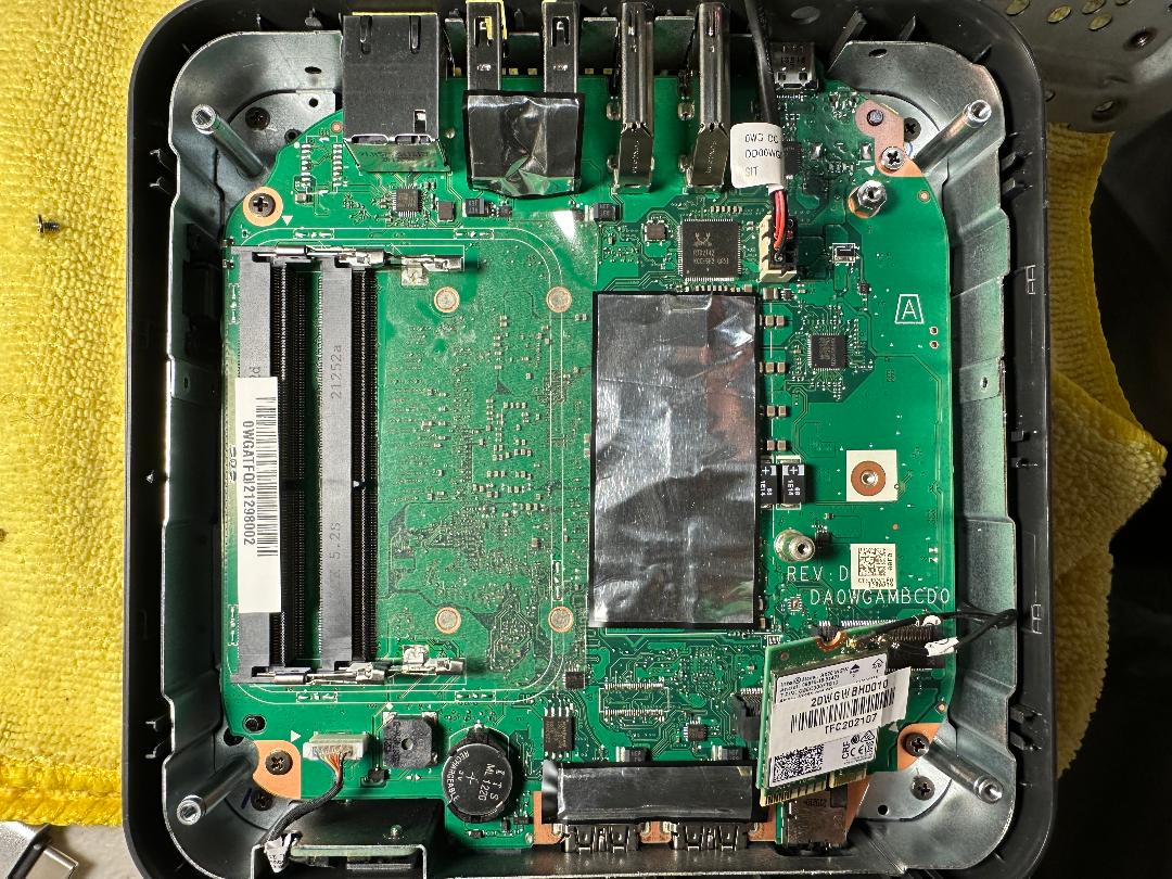

Photo without Memory and Under SSD is open spot, not sure if this Was WP screw but usally it has a WP marking on Board.
SMH. you board has the exact same jumper pair as the pic I posted above.
there’s no screw. my site tells you exactly what WP type is used for each device. It has the pic posted above. Not sure what else I can do here.
They are clearly NOT the same. Thanks anyway for the try.
they clearly are the same - his is just zoomed in on the jumper
