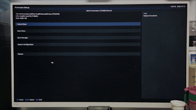

[Mouse doesn’t work in the firmware setup.]
  1. Updated the firmware by the script. Reboot and press ESC key.
  2. A new UI appears, and a mouse pointer in the middle of the screen.
  3. When I move the mouse to the left, the pointer moves up. When I move the mouse to the right, the pointer moves down. And the pointer moves to the right when any button pressed, and can’t get back.
