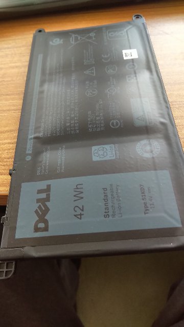

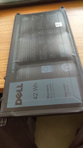

Update - Fixed
The root cause was a swollen battery, which was pressing on the underside of the touchpad. Amazingly, the battery still worked and had about 50% capacity. I replaced the touchpad with a used one and installed a battery from Amazon. It was an easy fix. Thanks!
