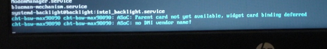

[KIP] No DMI Vendor Name: ASoC: Parent Card Not Available
This shows up when I boot Linux Mint, HP Chromebook 11 G4, what can I do?
Main Issue: No Audio

The audio drivers on these old devices check if the dmi system vendor is google to apply some quirks. dmesg clearly says the vendor is unset, which is a stock firmware bug. Using full rom will fix this issue.

because GalliumOS has a lot of hacks to work around issues in the stock firmware. It’s also dead 6+ years now.
