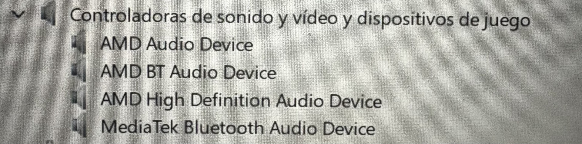

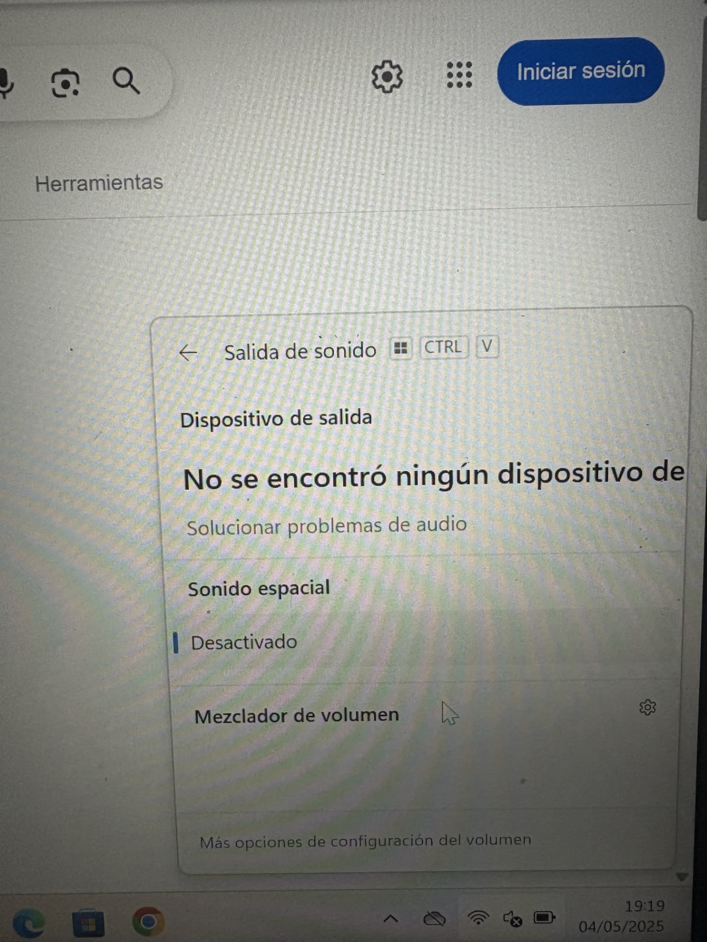

Hello friend, thank you very much for everything you helped me, in the end I managed to solve it, it took me 2 days searching and searching on the internet and forums, but I already have wifi, bluetooth and everything, the only driver I am missing is the audio one, I have found several on the internet but none of them have worked for me, do you know what driver it could be?

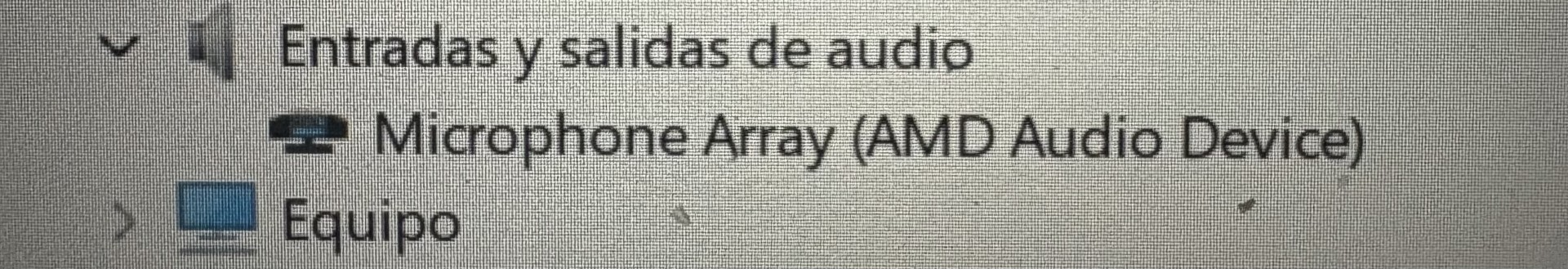

I have managed to install all of these, but none of them work for me, the audio still does not work, the only thing I have managed to get working is the microphone.
you need coolstar’s AMD-SOF drivers. There are no other drivers which will work, they don’t exist otherwise.
