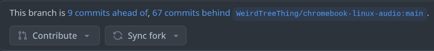

@ChocolateLoverRaj Release v0.8.1 · ChocolateLoverRaj/chromebook-linux-audio · GitHub doesn’t seem to work on Fedora 40.200 Silverblue. Does the package work for you and what version of fedora do you use?
I don’t use Fedora anymore. I use NixOS. My audio fork for silverblue is pretty old, so it may need to be updated to work on Fedora 40 silverblue. What Chromebook did you try it on?
