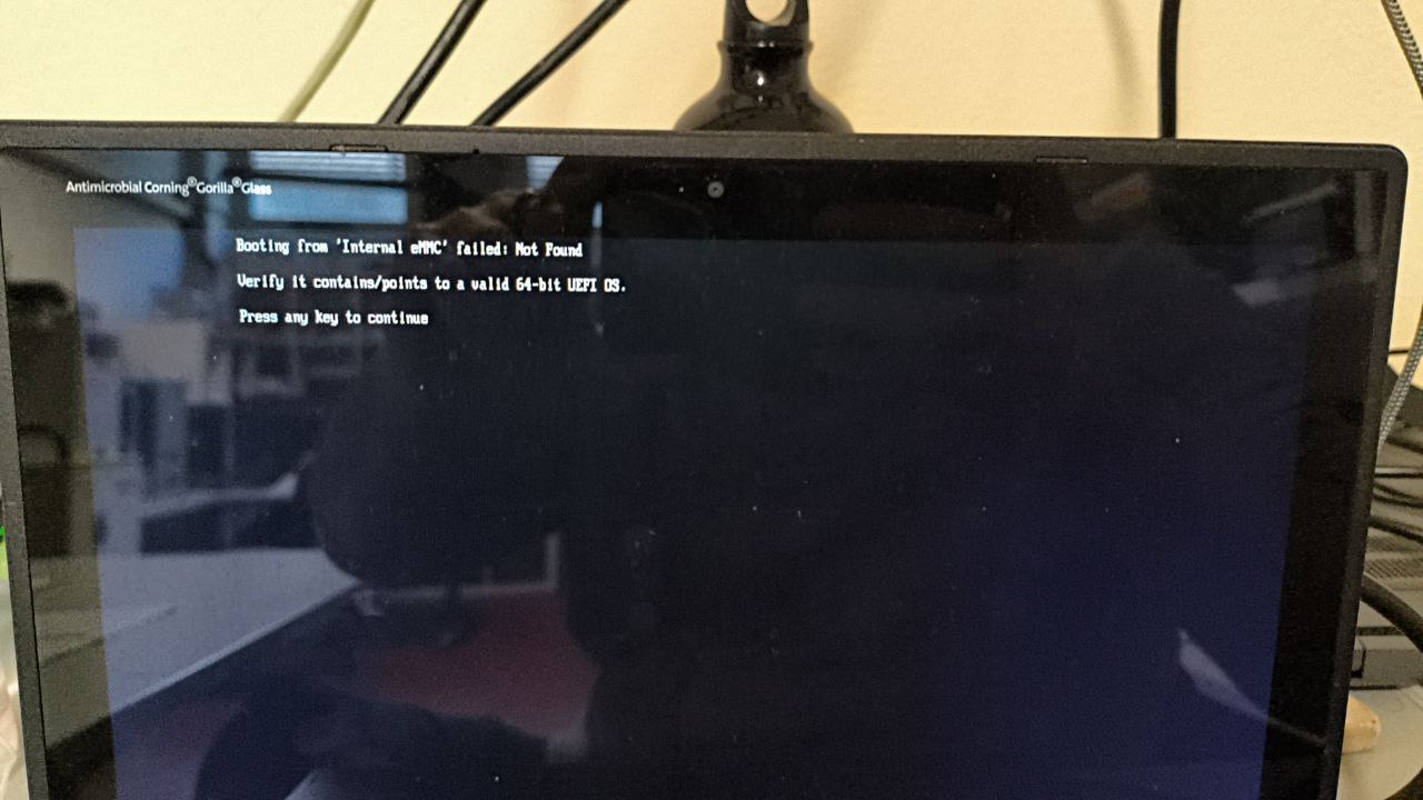

I keep getting "Booting from 'Ubuntu' failed: verify it contains a 64-bit UEFI OS." error message

OK, I’ll try to put it back together, but when I go to eMMC, I get the following image.

the error means that there is no EFI bootloader on the disk that it can find, so I’m asking you if it actually exists – can you boot from it manually
No, by selecting the eMMC it doesn’t boot and I don’t think it exists, how do I fix it?
I have installed LBuntu multiple times on the internal memory but it doesn’t detect the disk at startup.
The installation sees it, it’s the BIOS that’s not working, if I can make you understand what I mean.
you established that in the OP. I didn’t ask that, I asked if you were able to boot from file using Boot Manager, if the EFI boot file actually existed.
that’s incorrect, the Boot Menu shows the internal eMMC. It is most defectly detected.
we don’t know that, which is why I asked if the EFI on-disk bootloader actually exists.
I am asking you to go to Boot Manager, Boot From File, select the first partition shown, then see if the file/path EFI/BOOT/BOOTX64.EFI exists. That’s how UEFI booting works when no alternative path is specified. If it exists, try to boot it. If it doesn’t, but an alternative path like EFI/UBUNTU/GRUB.EFI exists, use that
