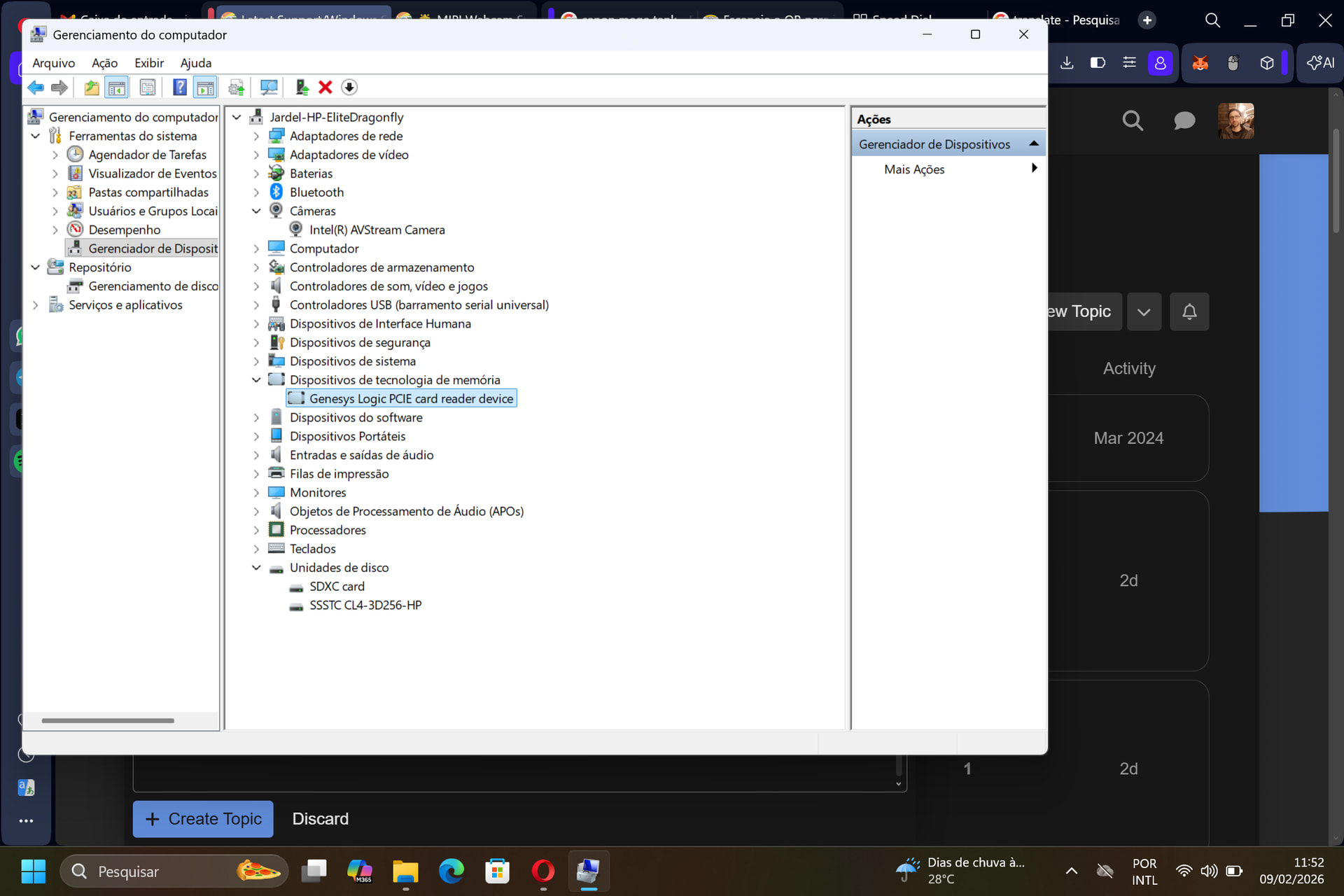

Looking at the Coolstar support page for the HP Elite Dragonfly, REDRIX board, it states that the card reader doesn’t work, but it’s possible to make it work by installing the “Genesys Logic PCIE card reader device” driver.
I want to thank MrChromebox, Coolstar, and vibecoder9000 for all the work they’ve done to get this Chromebook perfectly functional on Windows 11 and Linux.
Indeed. The card reader driver is included in the 3rd-party-autoinstall from vibecoder linked in the Redrix page
I suppose the coolstar status page saying N/A for card reader for all Alder Lake boards is just outdated. There’s a changelog entry on MrChromebox 2509.2 indicating this is fairly recent:
Added support for Genesys Logic GL9750/9755 SD card controllers (still WIP)
