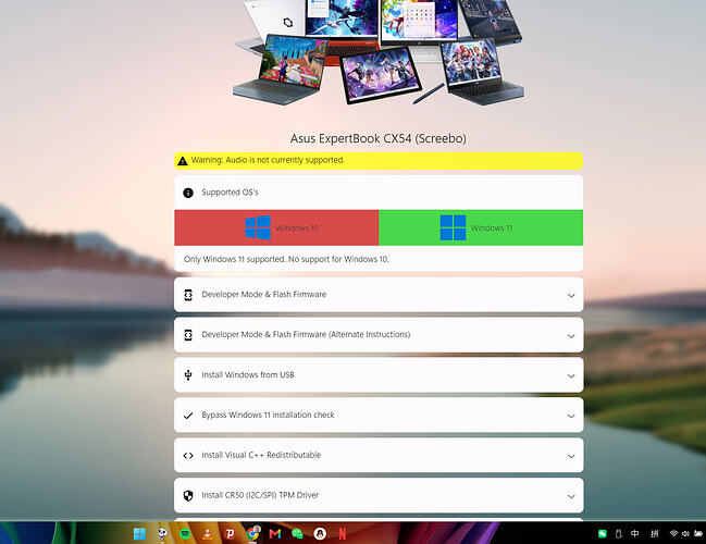

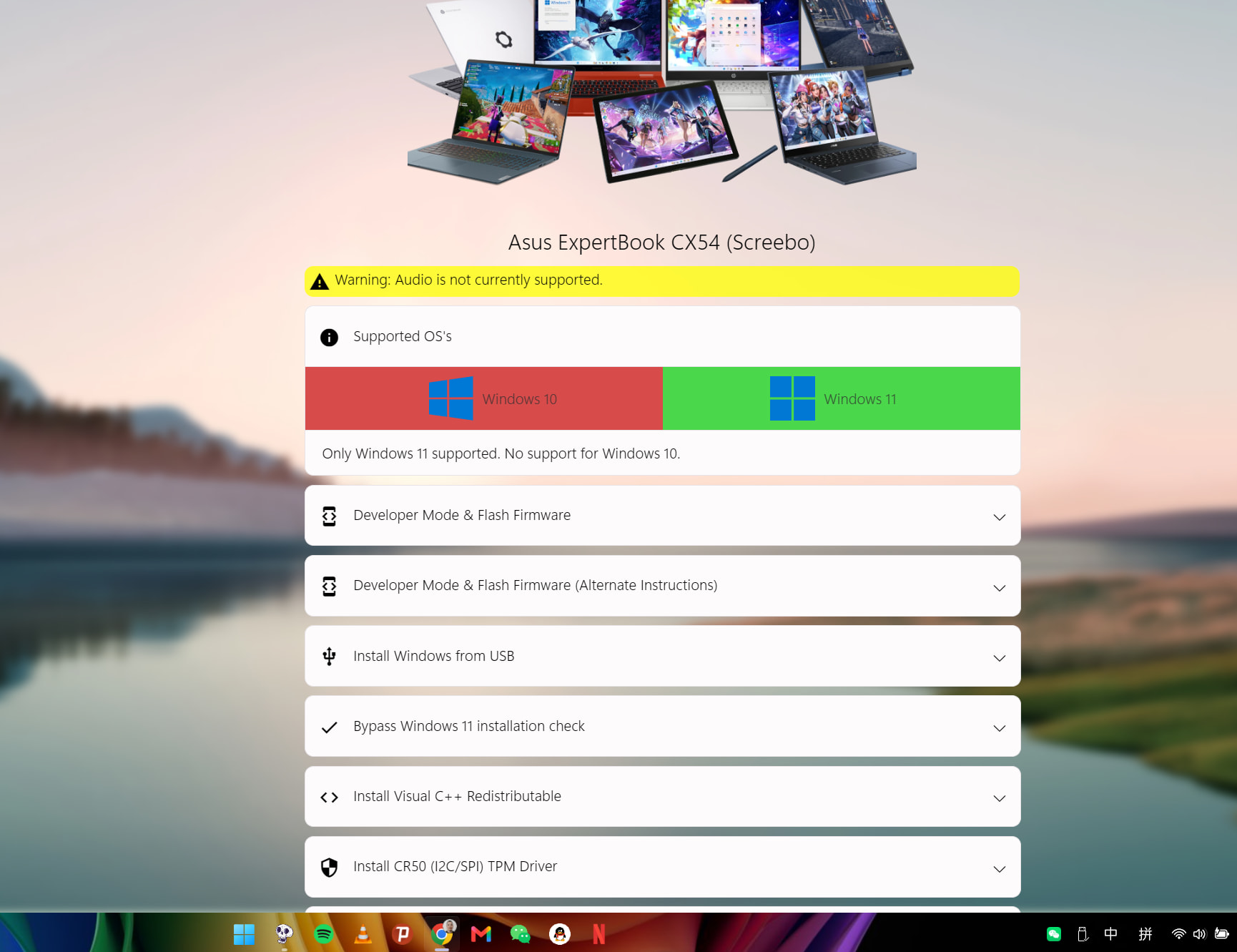

The issue you reported is not related to MrChromebox UEFI. It was caused by resetting the Windows system and dropping the external Coolstar driver. If you didn’t install the driver yourself before, you would need to purchase and install the Coolstar driver again.

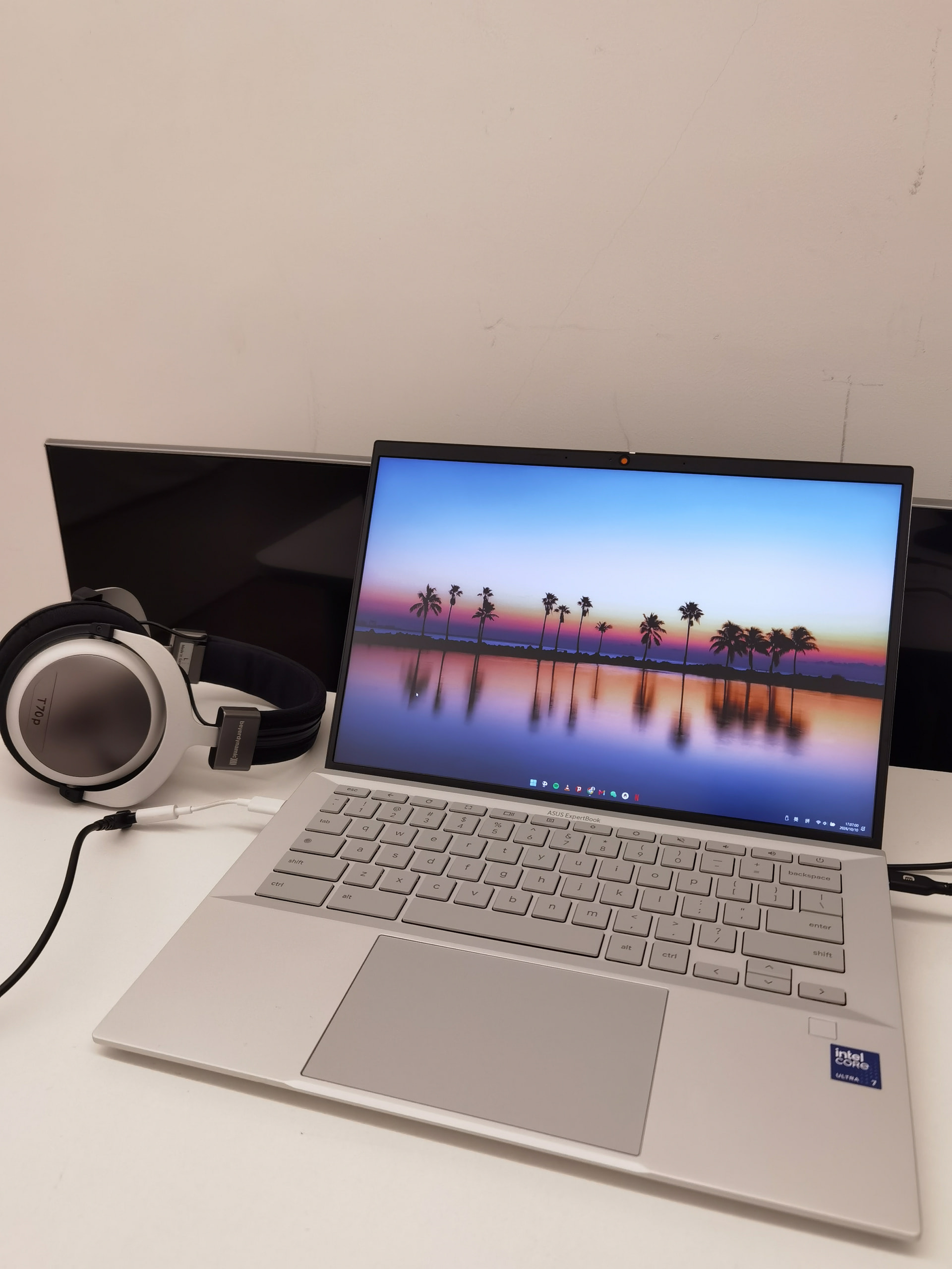

In fact, there is no need to use the Coolstar sound driver to use the built-in sound. A Type-C to 3.5mm adapter can solve the problem, as most Chromebooks have a fully functional Thunderbolt Type-C.
The device I am currently using is too high-end and advanced, and there is no official Coolstar external sound driver for Windows 11. It can still use Windows 11 lot 24h2 ltsc normally
a USB-C to 3.5mm jack is not built-in sound, it’s external sound.
