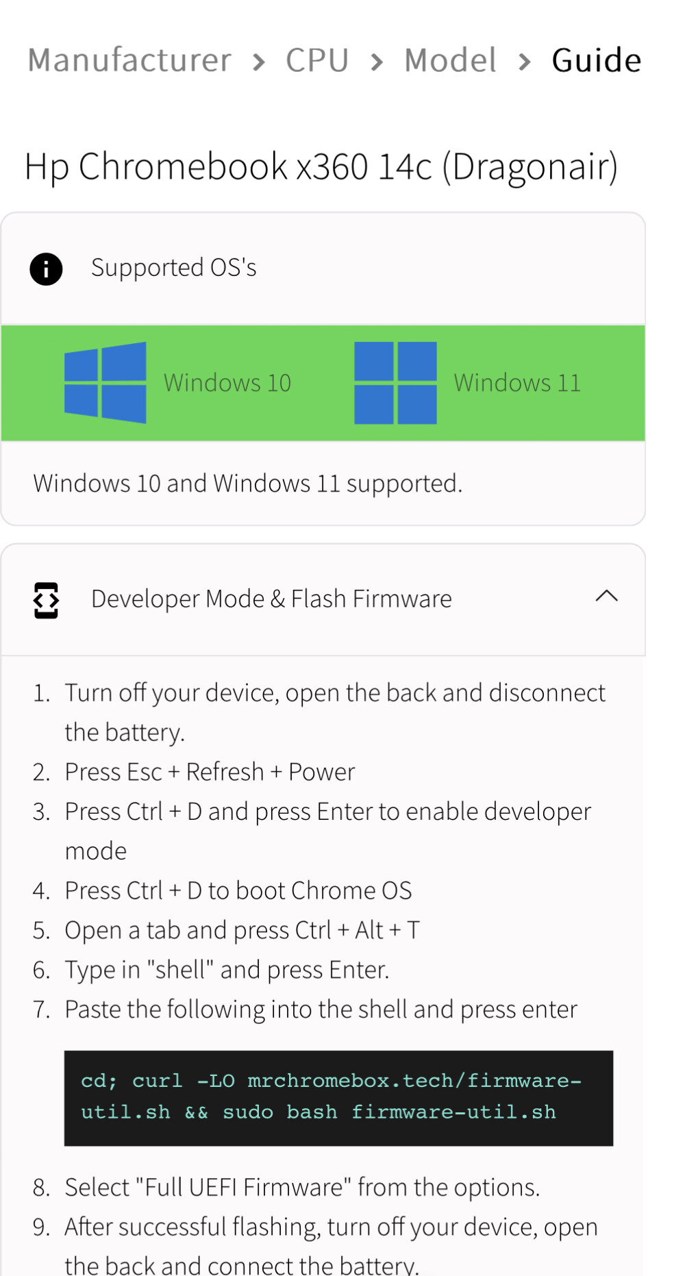

, so basically to put it into recovery mode I should press esc, refresh and power , it dosent want to go into recovery mode it boots normally, I’ve tested the keys with a keyboard tester online , it’s not enterprise locked or anything like that , there is a Google account on it , so I’m a bit confused, do you think chrome changed the way you get into recovery mode ? I even tried power + maximize + refresh , still nothing , I did disconnect the battery etc. I was also wondering if you could force it into recovery mode by removing the os ? Not sure how I’ll go by doing so.

please link to those directions so they can be corrected. You need to enable developer mode before attempting to disable firmware WP via battery disconnect
When I go to the link it brings u to the start so here is a image below and May I ask , what is the correct way ?

to enter Developer Mode, you have to boot to Recovery Mode, yes.
Try pressing and releasing all 3 keys simultaneously, or pressing/holding ESC+Refresh then press/release power, wait 3-5s, then release the other two keys
