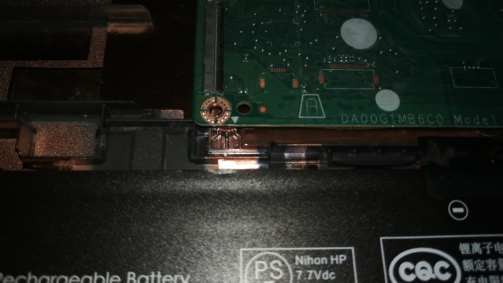

HP Chromebook 14 (SNAPPY) write protection may have a screw option
  • Device: HP Chromebook 14-ca061dx (3JQ73UA) and HP Chromebook 14 G5 (3UZ96UT) [SNAPPY]
  • OS: Manjaro
  • Firmware Type: UEFI Full ROM (updated from RW_LEGACY)
  • Firmware Version: MrChromebox-2606.1 (07/14/2026)
  • Internal storage type: eMMC
Summary
Site may need to be updated. I discovered on two versions of the HP Chromebook 14 (both from 2018) with the SNAPPY board do not have WP associated with the battery, but with a screw instead, which was identifiable by the line going through the copper circle around the screw.
I did not have to remove the battery, but I did have to add -k to the curl command to bypass SSL certificate checking for the full ROM installation (even though the legacy option worked without it).
cd; curl -LOfk https://mrchromebox.tech/firmware-util.sh && sudo bash firmware-util.sh
MicroSD detection also confirmed to work.
This was the screw location that I removed. Incidentally, I was looking at the FALCO video as well, but it looks different from that one too.
