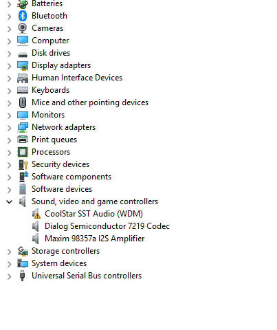

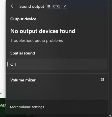

I have purchased and installed it, but I still can’t get any sound from the speakers of the Chromebase 24v2. Could you please guide me on how to set it up?
