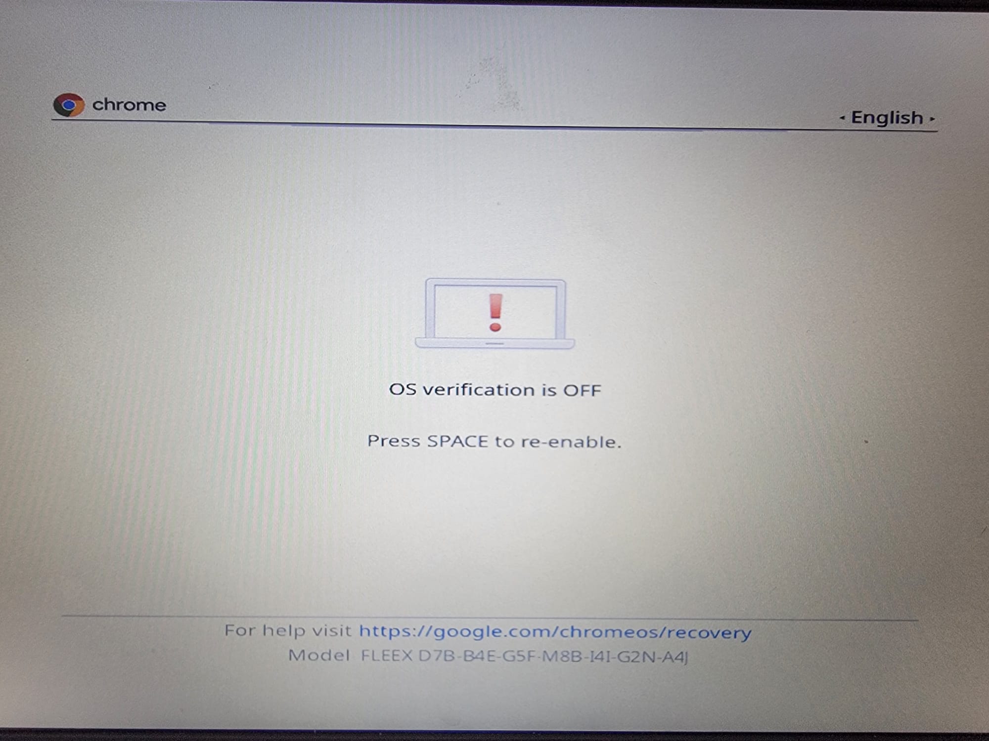

Does anyone know how to enable the Legacy Boot Mode on the Dell Chromebook 3100?
When I run CTRL + L shortcut to boot in legacy mode (there is a Linux Mint drive plugged in), I get this menu:
rich text editor image
And when I try to run the TianoCore bootloader (which somehow came preinstalled), the computer entirely hangs, and I have to press the power button and redo this, yet to no avail. Does anyone have ideas on how to fix this? I have made the modification and RW_LEGACY seems to be there.

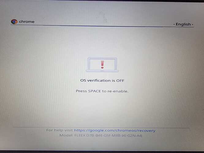

Press 2 on the os verification is disabled screen.
what does that mean? Clearly you haven’t run my script / installed my RW_LEGACY firmware, or it would be working.
it doesnt say OSVER is disabled
CTRL+D boots CrOS
CTRL+L opens the screen from the post
CTRL+U makes computer beep (once)
Is it possible to dual-boot or preserve chromeos and boot from LinuxMint?
no idea WTF you’re talking about. That’s the expected Developer Mode boot screen.
those are the expected outcomes
