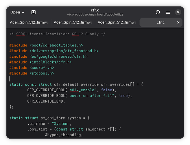

Before I compile and then brick my device with bad firmware, could you just let me know if I added this correctly?
I believe I only needed to add the override, correct?
That override I put in must not be correct, as I was able to build and flash the firmware, but there is no option showing in the EFI to enable or disable it.
the override just sets the default state, it doesn’t create/show the option in the UI – you need to add the option to one of the forms below like the other options
