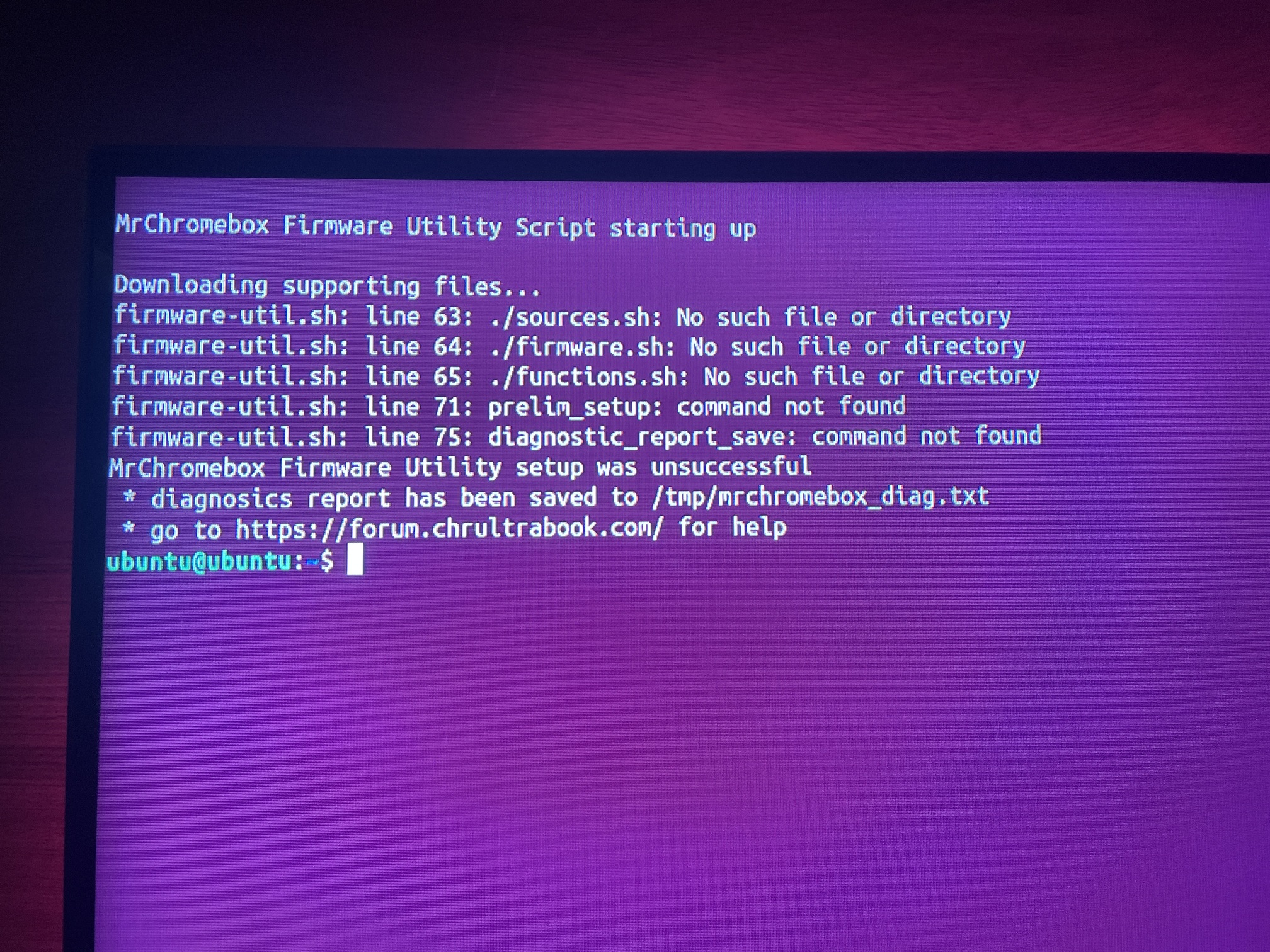

I get this error when I tried to run the utility script (im using ubuntu 23.10 here btw)
this is an issue with Ubuntu’s snap-installed curl. Uninstall it and install curl via apt and it will work properly

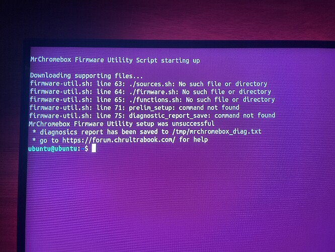

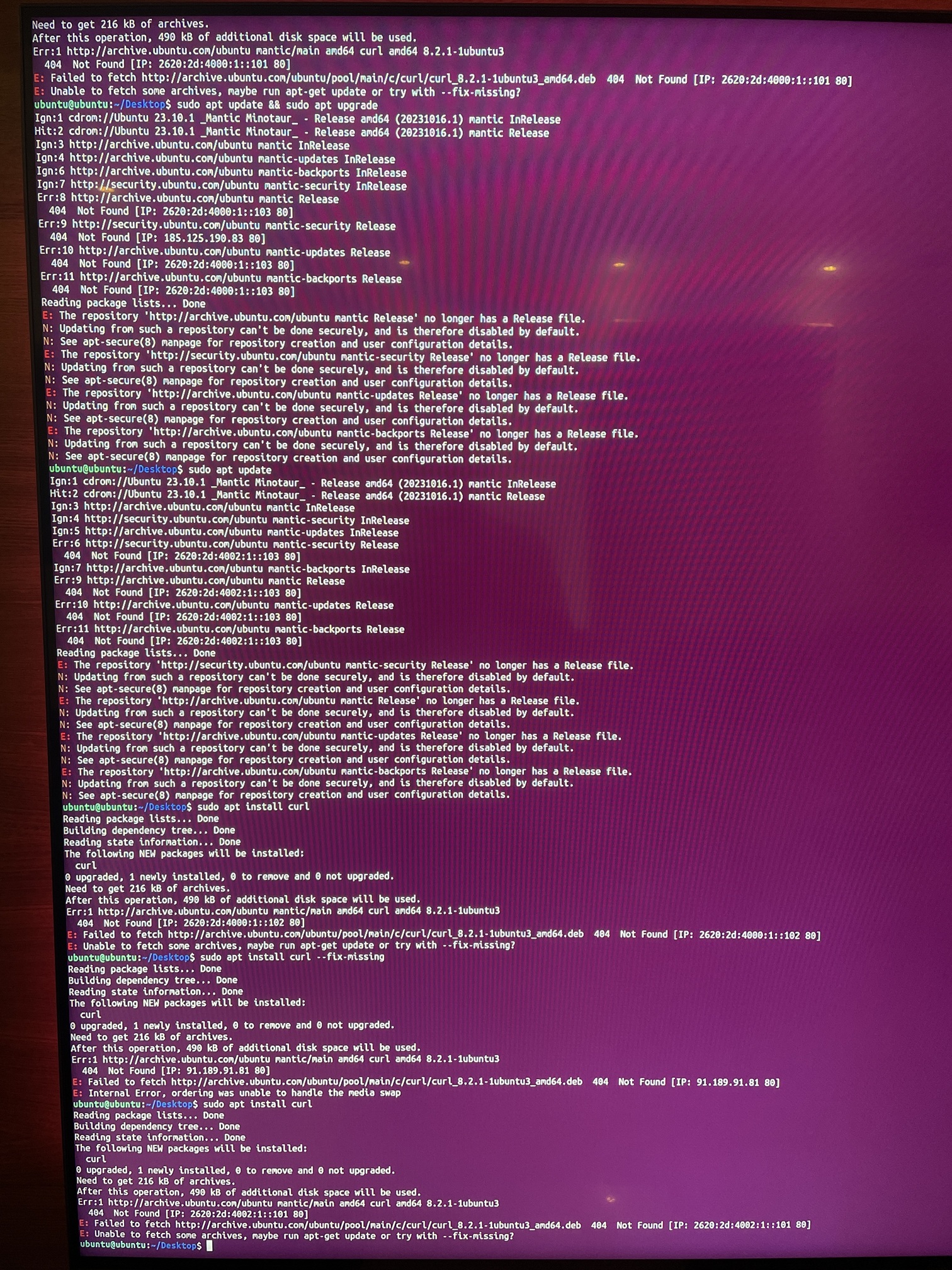

Idk if its because ubuntu 23.10 stopped recieving supoort or what, but i get these errors (image above)
(I uninstalled it from snap also)
Why are you using a version of ubuntu from 2023?
just live boot the current version of ubuntu, you won’t have issues with it

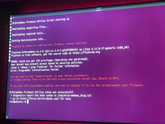

I was using an older version of Lenox because when I tried to run the script in the newest version this would pop up, ive tried searching how to make the kernel more “permissive” but found no results that suited me.
it literally tells you there in the error msg:
  • disable secure boot
  • add iomem=relaxed to the kernel boot params
also, the docs are explicit that you should not run the script as root – it helps to follow the directions.
Ubuntu 24.10/25.05 do not require anything special permissions wise.
I’ve researched and found thet secure boot is meant to be disabled from the BIOS, and the coreboot bios doenst allow me to do that, is there a command for it?
As for the iomem=relaxed and root permissions, i’ll take that into account thank you!
if your chromebox is running a reasonably recent version of my firmware, then it has a setting for Secure Boot in the firmware setup options screen, under Advanced Configuration.
you shouldn’t need iomem=relaxed if you’re booting a recent version of ubuntu from USB
