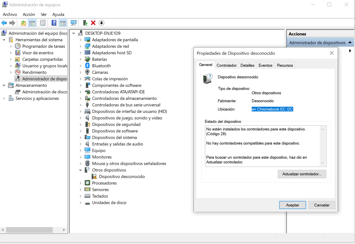

I recently flashed my Chromebook to CoreBoot so I could install Windows. I went to the CoolStar website and downloaded all the drivers from there. I even have audio, but my problem is that when installing the “Cros EC” driver, where the sensor is installed, the keyboard lighting, chromebook key driver, when doing this my screen turns to the left, and at the moment of turning it to the other side, it turns to the wrong sides and the screen rotate is always activated, without even having made the screen backwards (360), then seeing missing drivers in the device manager, I noticed that I was missing several, I uninstalled the “Chromebook EC sensors” driver and I no longer had the screen turned to the left and with a driver program , I installed all the recommended ones, Also install all Intel chipset drivers , and then in the end I reinstalled the general “CROS EC” driver and this time the screen did not turn to the left, and when doing the 360 ​​degrees now the keyboard was disabled and the orientation worked, but it only works, in Horizontal orientation and orientation to the left, but the other two do not work They are the ones above and on the right. I’ve done everything, installed Windows from scratch like 10 times, tried a thousand drivers from the internet, tried several versions of the CroSec driver, all with negative results that even broke the blacklight on the keyboard. So I don’t know what else I can do or try to make the sensors work properly in Windows. I returned the firmware to Chromebook, I reinstalled Chromebook, and the sensors and orientation worked perfectly, so I don’t have a hardware problem, but a software problem. I need someone with a similar case who has been able to solve it on this computer. I also tried with Windows 11, and got the same results as with Windows 10. By the way, now in the device manager I only get an unknown driver that I have not been able to identify, what could it be? Could it have something to do with it? I’m attaching a photo:

hermano yo tengo el mismo modelo a mi no me da ese error pues no encontraba como encender el teclado pero gracias este post lo logre, solo me falta el audio donde puedo conseguirlo pues he intentado de todo y nada este es mi correo [email protected] si me podria ayudar con ese ultimo driver
