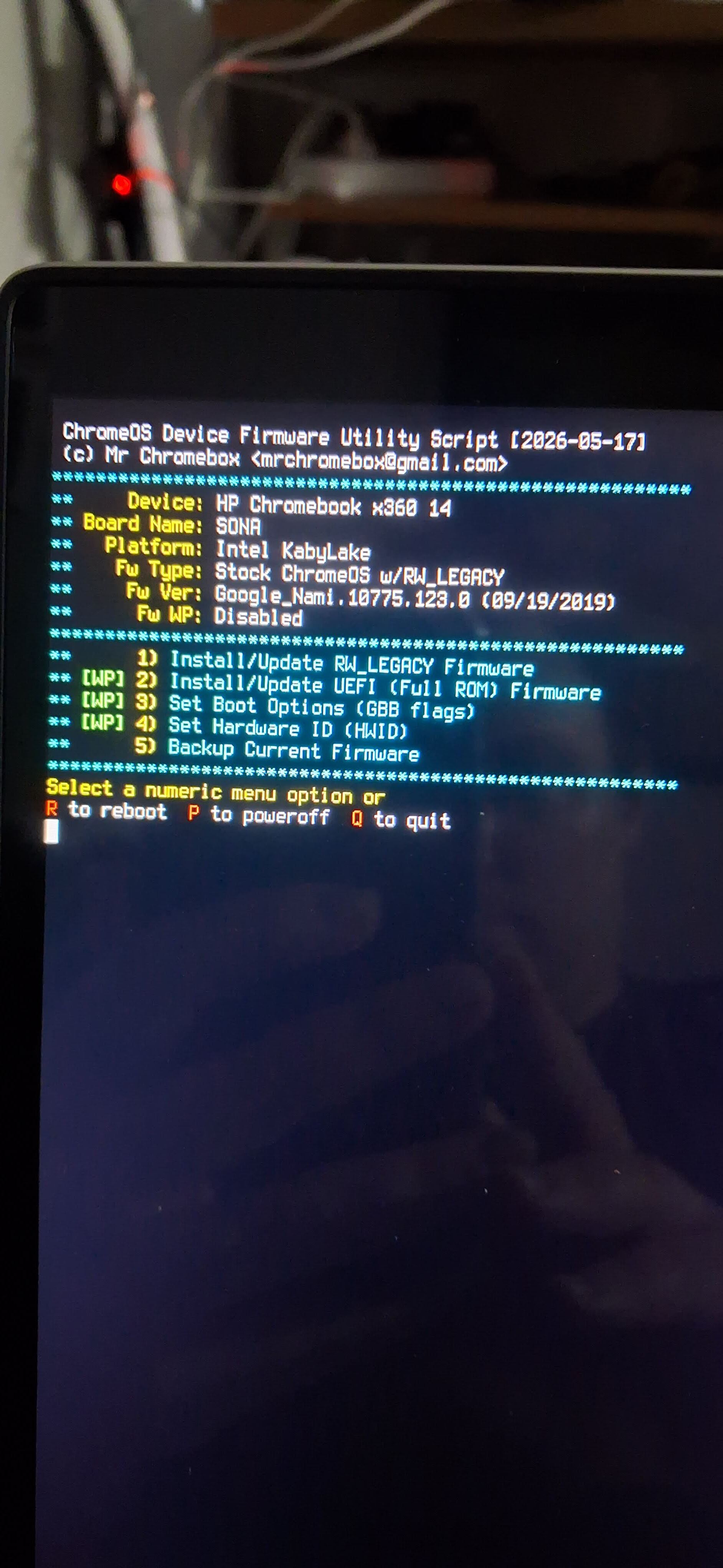

So, today i tried to follow mrchromebox’s guide to dual-boot but i fckd and i think my Chromebook is bricked.
I could sucefully load Firmware Utility Script (pic 01).

UPDATE:
I’ve managed to use Rescuezillaon a usb pendrive. Then i’ve follow mrchromebox tutorial and sucefully managed to restore Stock ChromeOs.
I’m note sure what i did wrong on the first place but i’ll read the guide again, calmly.
