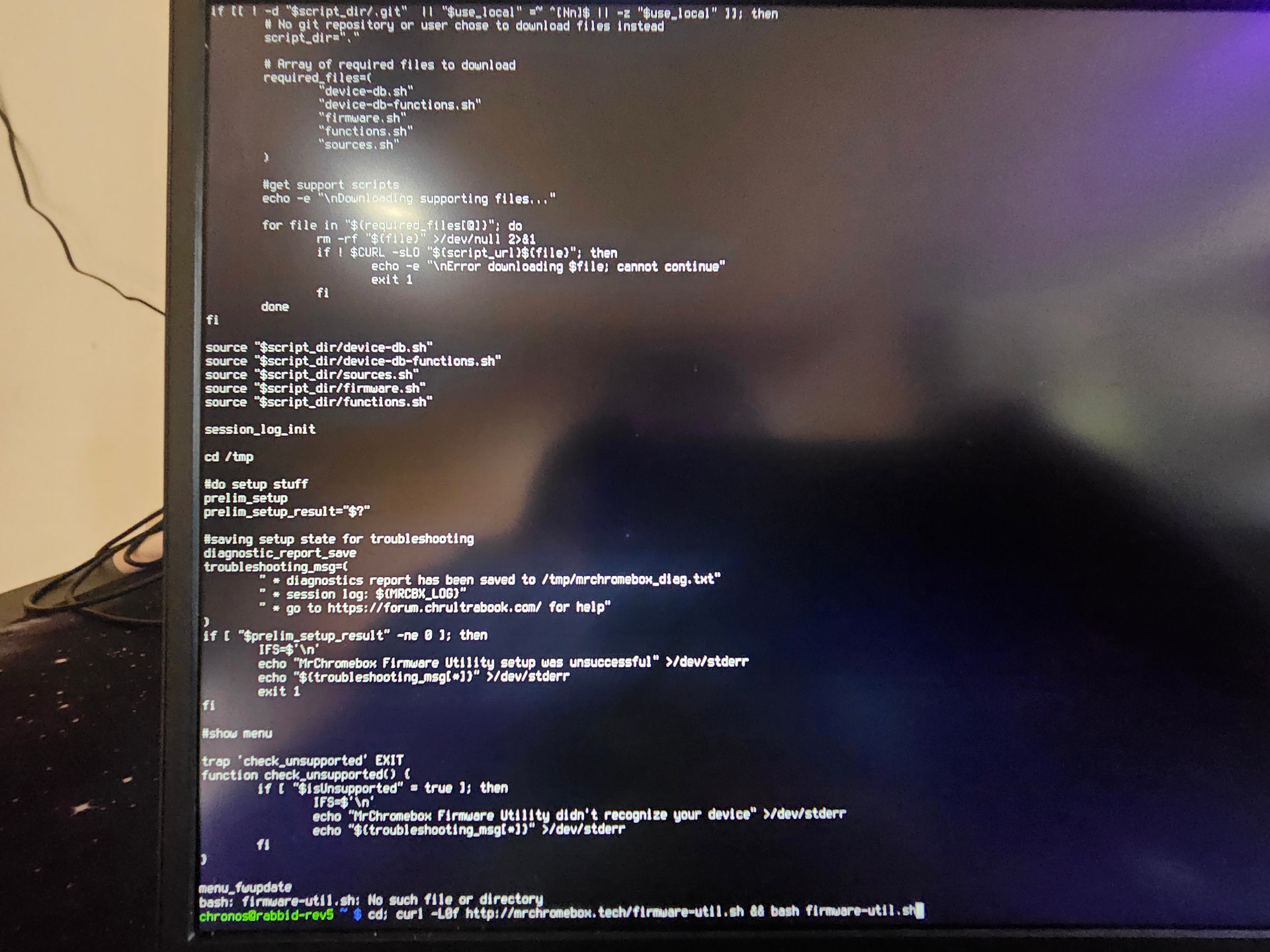

Help I don't think the full ROM flash files are in the directory for RABBID
  • Device: asus c423n
  • OS: ChromeOS
Every time I run the full ROM flash, it tells me that there are no files found in the directory for this model. Even though on the webpage, it says my model is fully compatible.
that picture shows you running the script incorrectly, using zero instead of capital letter O. Reading and following instructions are pretty critical when doing something like flashing firmware.
Where are you getting that the there isn’t a file for your device?
At the bottom right above the command it says that there isn’t a file or directory.
But I will still try and fix the command and see if it works.
SMH. you’re not even running the script. You’ve output it to screen. and you’re using the wrong command, clearly.
