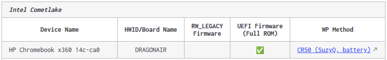

Hi, i want to install Linux but when i run the mrchromebox script i have an error saying that writing protection is enabled. So after some research i looked for ways to disable it but i can’t find the screw or any points to short-circuit. Can you help me find them on my Chromebook x360 14c-ca0004nf with a dragonair motherboard
is the information on my site unclear?
No no they are great but i can’t find the screw/contact point to do
please show me where on my site it says that DRAGONAIR uses a screw or jumper
I have a dragonair and there is no screw it uses cr50 and you need to unplug it to disable the WP security on it
Read up and skip everything that says jumper etc..
You should be good
