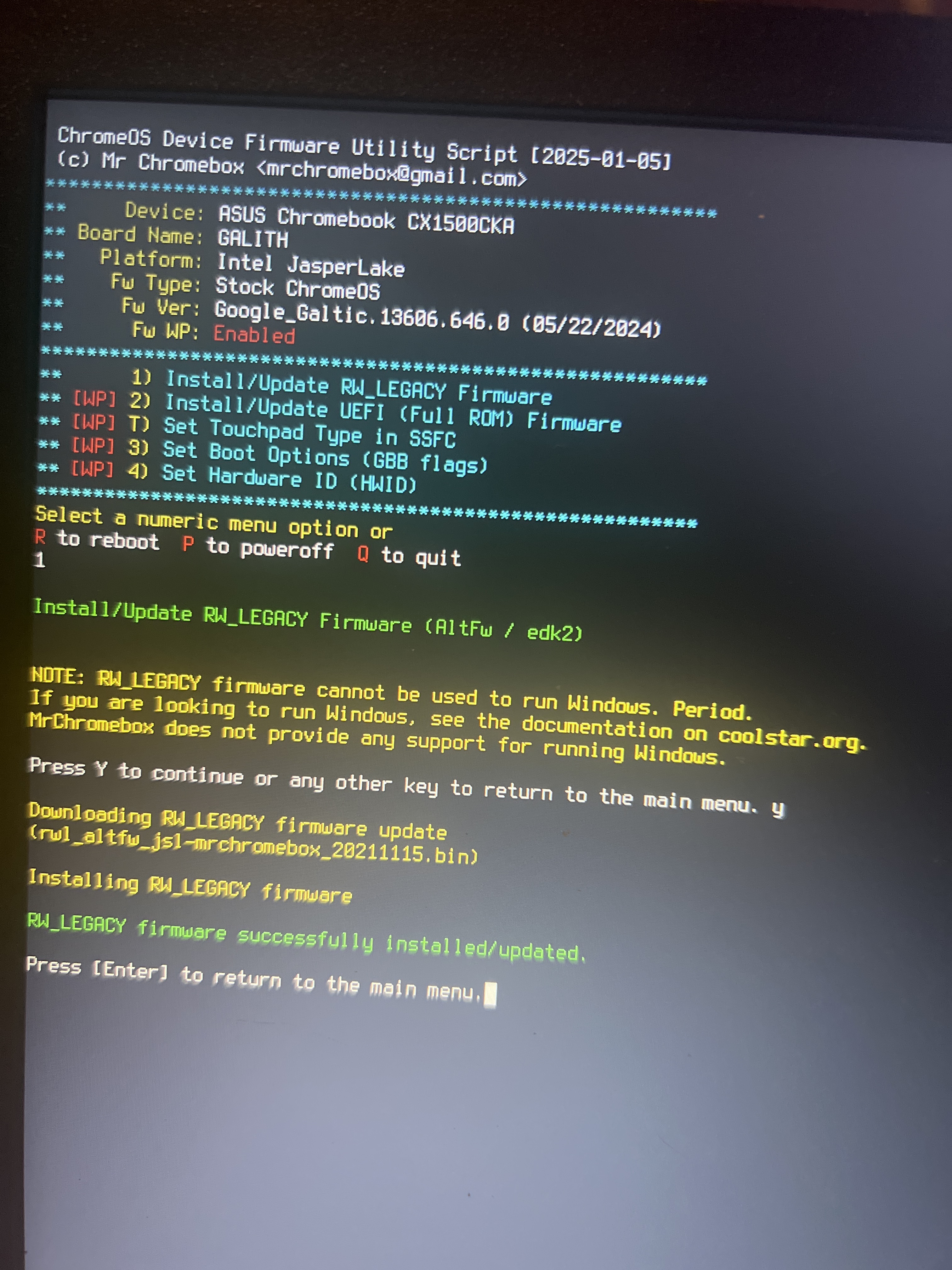

Hey I’m trying to get windows on my Asus CX1500CKA and WP won’t disable help!! Yes I’ve disconnected the battery don’t ask!!!
Did you disconnect the battery from the motherboard (rather than from the battery) and did you boot with the battery unplugged (rather than unplugging it while turned on then running script)?
