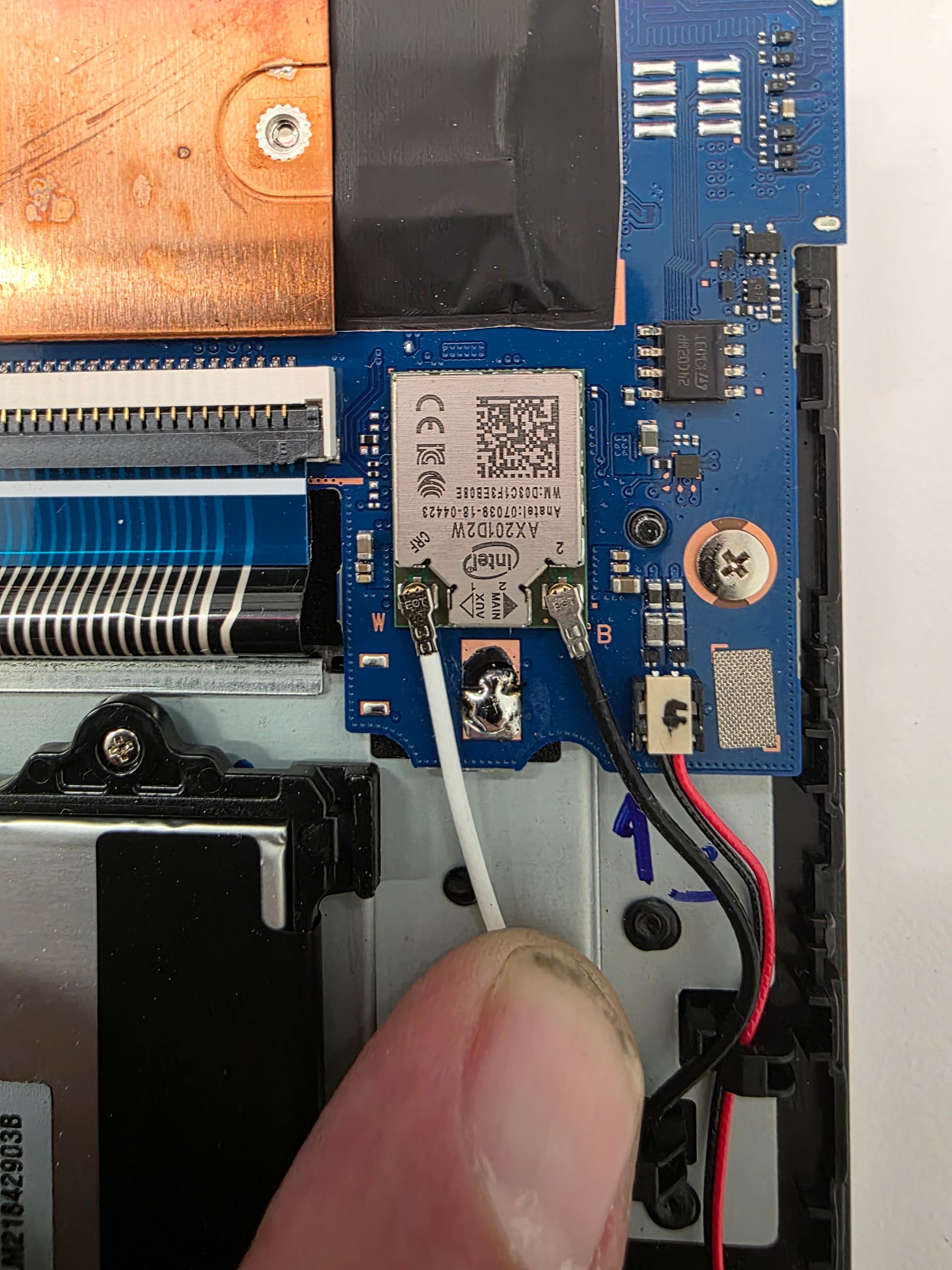

Gsctool -a -o doesn't work. Chromebook Go from AT&T
I have followed all the instructions and even ordered a Suzy Q adapter to try and get this thing to turn off write protect. I am able to enable developer mode, login as root and then when I run the command “gsctool -a -o” it says “Press PP button now!” When I do so it says “Another press will be required!” then it says that several times over the next few minutes. Eventually it just reboots and disables developer mode. It never gives me the message, “PP Done!”. After that my Susy Q never shows up in /dev/ttyusb* so I can’t move forward. I’ve tried this several times.

it says PP done and reboots instantly, you’re likely simply missing it.
Nope I wasn’t missing it. It wasn’t working. After digging for hours on the internet I found that this model needed a jumper between two pads. There are two pads just beneath the WiFi. Once I bridged these points with solder I was able to disable write protection easily. Can’t believe it was so hard to find someone with a pic showing the two points. Turns out I didn’t need the SusyQ adapter at all. I took a pic.
