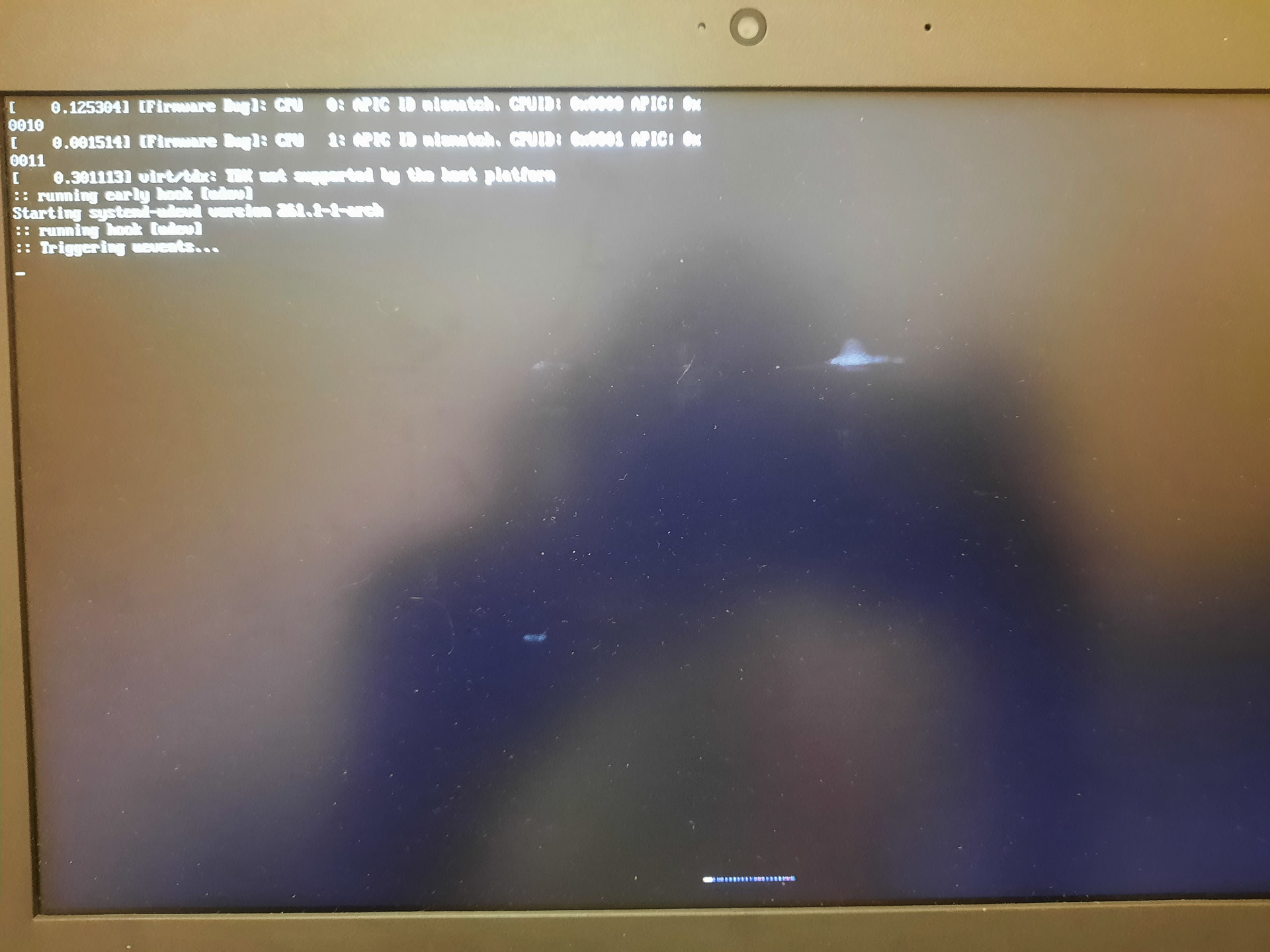

After Updating to the newest version of the bios chromebook stopped booting past Triggering udev events, a colorful line appeared on the bottom.
Also other distros boot fine.
and its frozen on this screen
i will also include the image i took when installing:
i couldn’t upload another image so ill upload it here

The driver is hanging the boot process, used nomodeset flag to bypass
something must have changed between v2512 and v2606 in the graphics or smth

well it isnt working and only thing getting it to boot is setting nomodeset
when i do it w/o it it just freezes with the small pink stripe,
