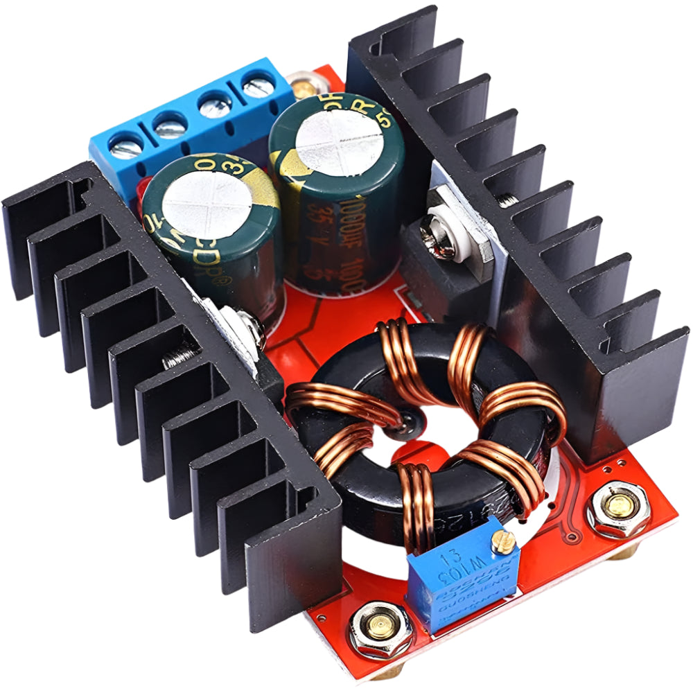

Use a UC3843 or similar step up converter.
Heh yess thats good idea. I will test it within few days :slight_smile:

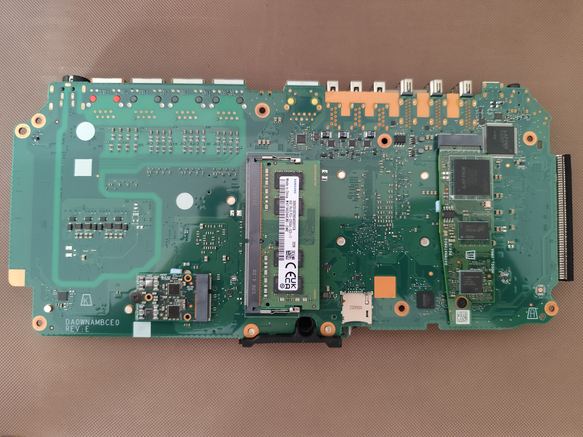

Now: ive Successfully flashed the spi chip with jumper wire.

Somehow i got a free 4gb stick on the back side. It does include AX201, M.2 E Key Dual edge TPU and I believe a Capture card with E Key interface.

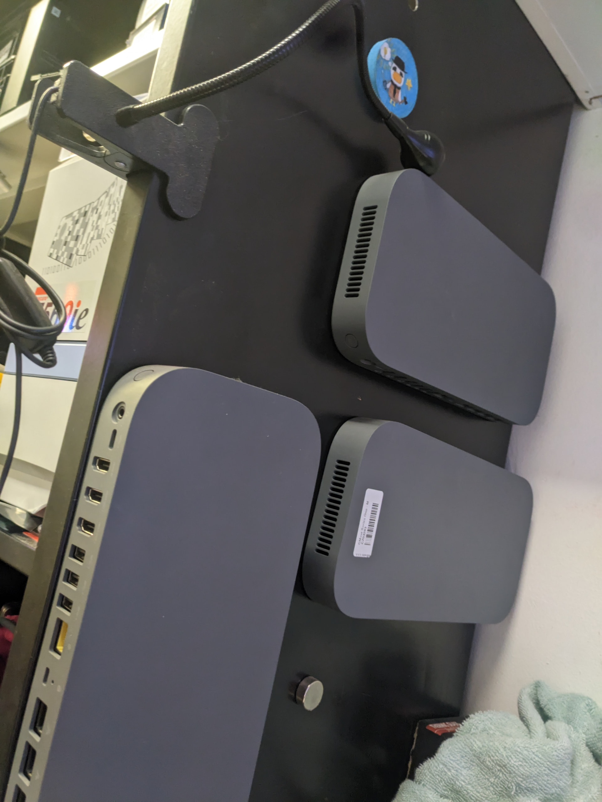

Without case? Excellent for modding project.
With case…
