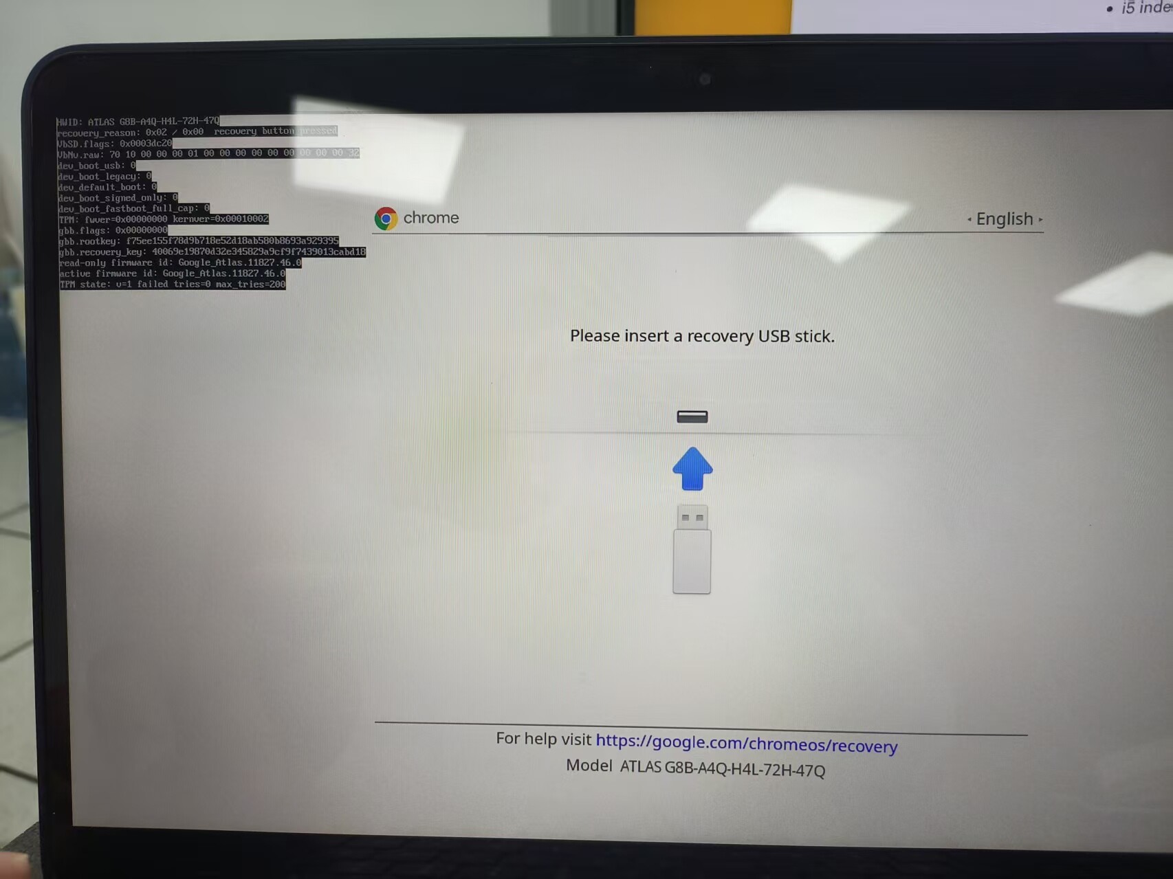

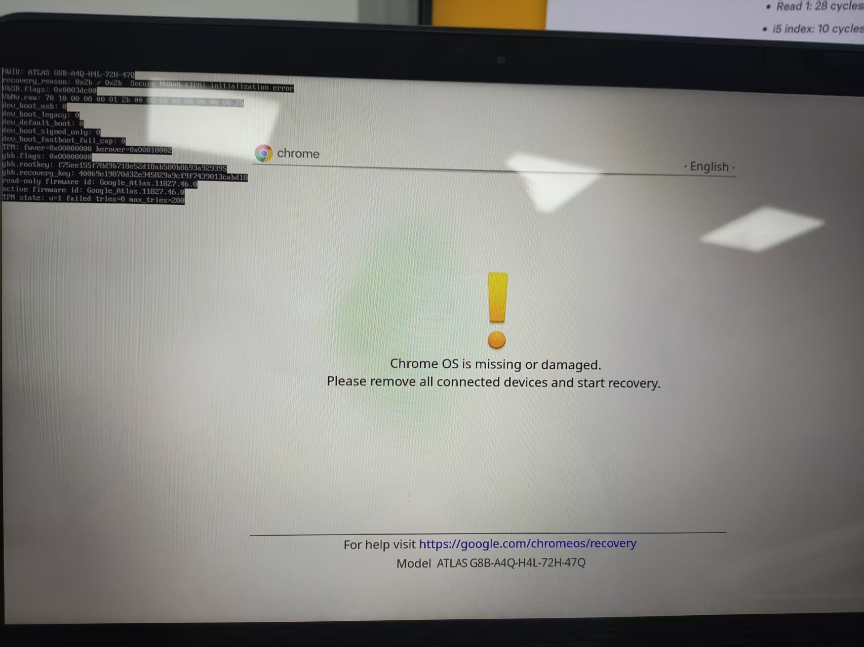

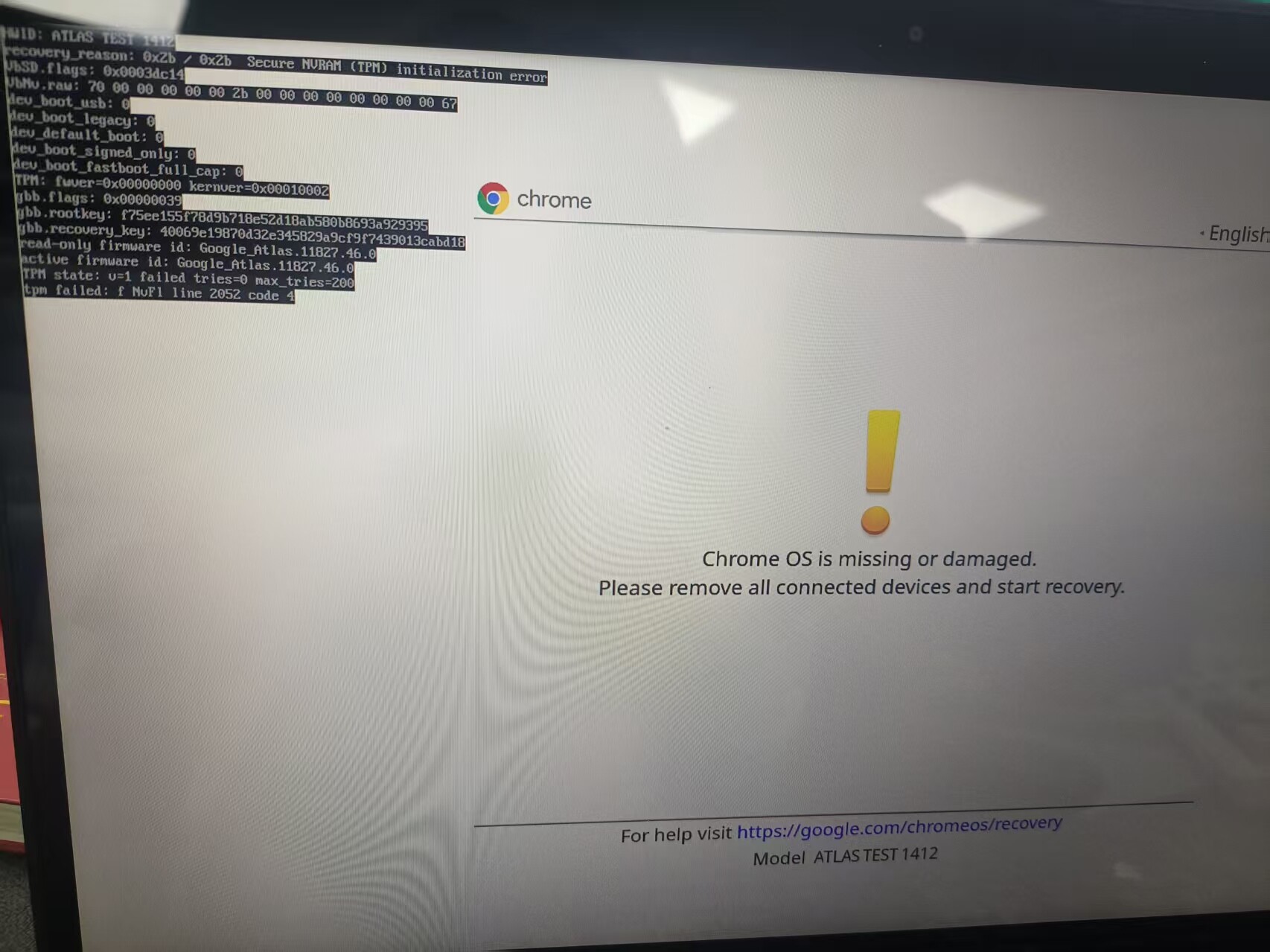

Hi everyone, I need help. I want to flash my Pixelbook Go back to ChromeOS. I used SuzyQable to flash the latest firmware coreboot-Google_Atlas.11827.198.0 onto the Pixelbook Go, and got the results shown in Figures 1 and 2. Then, according to the posts, I tried to use the crosfirmware.sh script to create a shellball firmware, and got the result shown in Figure 3.
please DM me here or on Discord, think I have a solution, just need a tester
I’ve added a new feature to the script which automatically restores the CR50 NVRAM to its default values for TPM and kernel version when restoring the stock firmware, so hopefully this issue will not been seen anymore.
For anyone else encountering it now, you can flash the UEFI firmware via SuzyQ, then re-run the script and restore the stock firmware again. It will automatically reset the NVRAM as part of the process.
