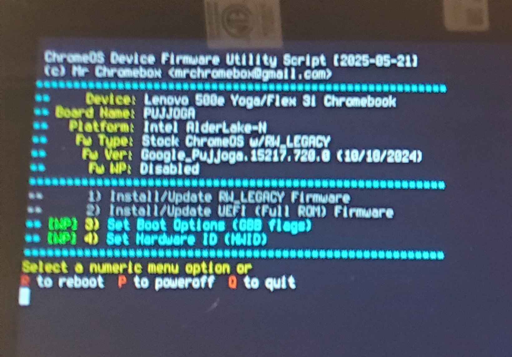

I recently tried to install UEFI firmware on the Lenovo 500e Yoga Gen 4s. I was able to disable write protect using a SuzyQable, but the firmware util script does not recognize the device correctly, and the firmware options are greyed out. Is there a simple fix to correctly recognize the device, or is it just not supported yet?
what does this mean? post a pic of the script menu. post the diag log created by the script when it doesn’t recognize a device.
There’s a reason the documentation explicitly says over and over and over, that the make/model are irrelevant. Clearly you have not read the documentation carefully or you would have provided the information that does matter – namely, the device’s board name
I apologize. I have attached the log and a picture of the script menu.
I will have to add support for PUJJOGA, it’s not supported currently
support added, obviously it’s untested so flashing without a suzyQ and a backup is not advised.
I can confirm it works. Thanks for your help
