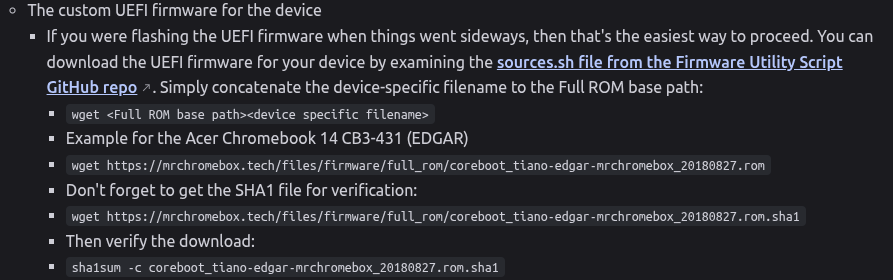

How is the unbricking documentation on my site not clear on this?

this was the reported url https://mrchromebox.tech/files/firmware/full_rom/coreboot_tiano-guado-mrchromebox_20191201.rom
and how did you come up with that exactly?
The docs say:
Your device name is not GUADO. And none of the filenames in my github repo have the _tiano prefix or are from 2019

well that’s great, Sergei is telling people to flash the wrong firmware.
