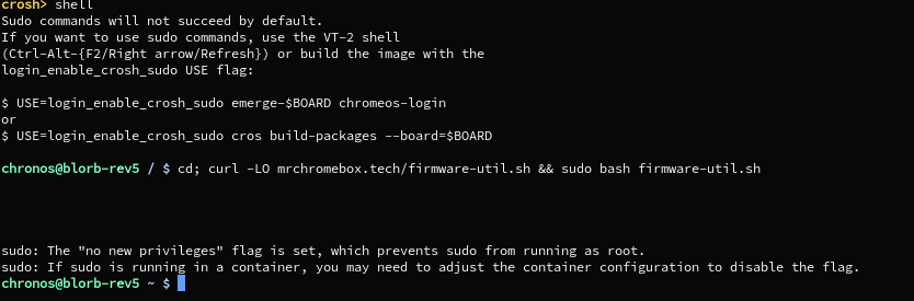

Error message when trying to run firmware utility script
When I ran the cd; curl -LO mrchromebox.tech/firmware-util.sh && sudo bash firmware-util.sh on cronos, it gave this
sudo: The "no new privileges" flag is set, which prevents sudo from running as root.
sudo: If sudo is running in a container, you may need to adjust the container configuration to disable the flag.
I then tried running the -k version and even that didn’t work. Any idea why?
Follow the documentation, and do it properly
because you fail to read things right in front of you.
If you want to use sudo commands, use the VT-2 shell.
it also says this in the documentation here and on my site.
This is a strong indication that you will have issues going forward, if you can’t follow basic directions on how to run the firmware utility script
