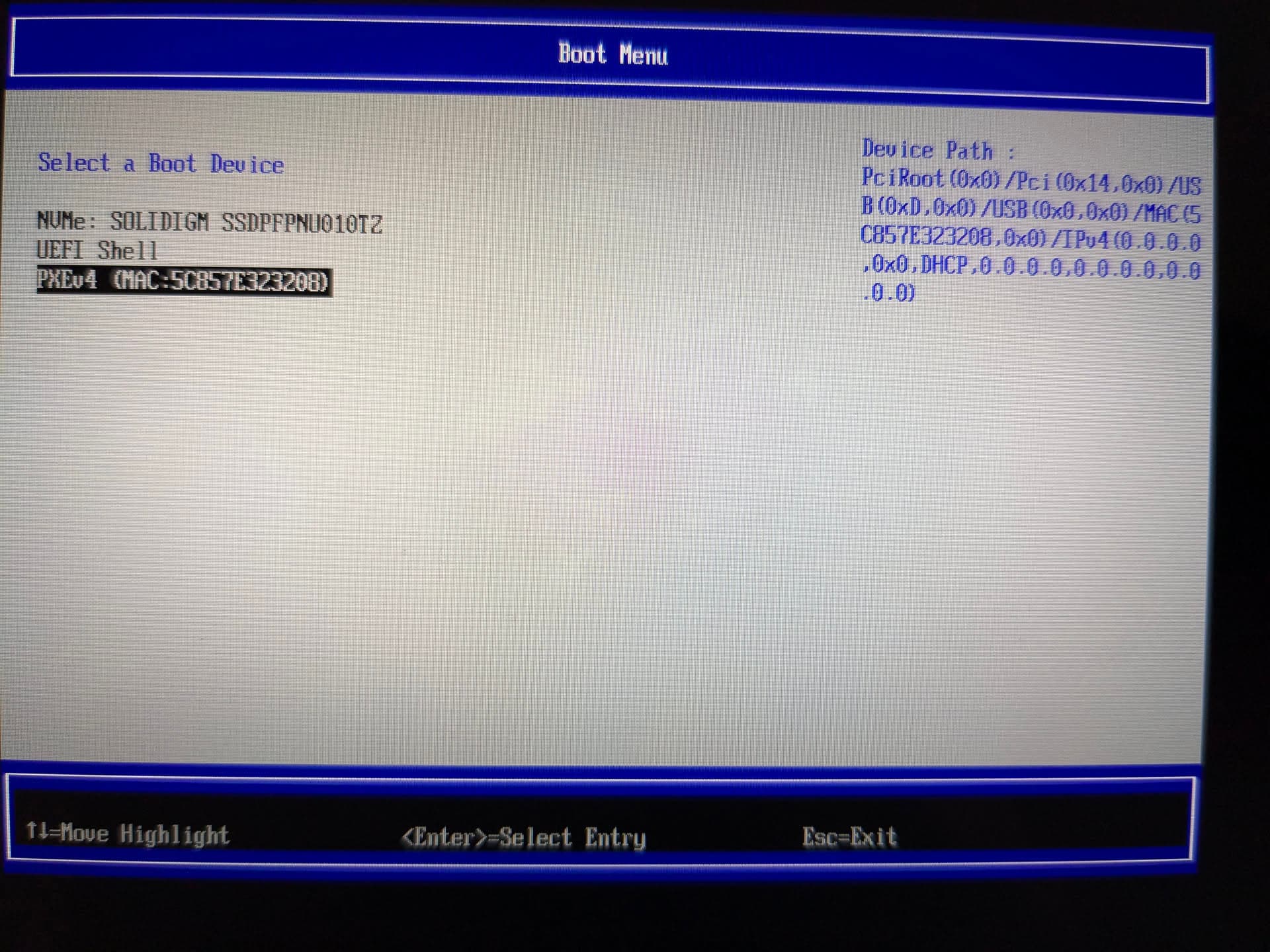

I added this (on Jinlon) and also the HTTP option and nothing changed in the firmware settings screen. Is a PXE option supposed to show up?
haven’t tested it in several versions/rebases. it should if there is a compatible NIC
I didn’t have any USB to ethernet adapter plugged in. Does it only show up if one is plugged in? Does it only show up if it’s plugged in and the ethernet cable is also connected?
it’s not going to add a boot entry for a device that isn’t present. cable connection doesn’t affect device detection
I can confirm that as long as a network capable USB device is detected PXE shows up as an option.
I did not set up a TFTP server but I was able to use netboot.xyz. I’m not sure how netboot.xyz works and if it requires enabling PXE in firmware, but it’s good that it’s working.

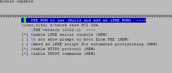

I’ve recompiled several times with several options. The only time I can get a PXE option to show up is using a USB NIC, never the onboard 10ec:8186 which is listed as a supported ipxe device. I’ve included both the stable and master versions of ipxe to no avail. What gives with that card?
