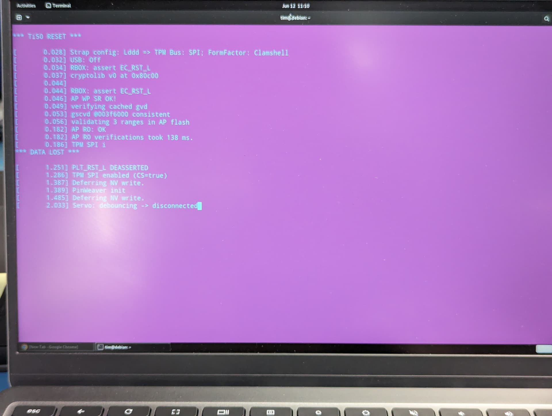

Hello all, myself and a few other users have had issues with disabling WP on Steelix and Rusty (and I believe a few other ARM devices).
None of the flashrom/futility commands are useful as hwwp needs disabled first. crossystem wpsw displays 1.
Disconnecting the battery does not disable hwwp.
I was able to disable with SuzyQ and gsctool but not externally with a Linux machine. This takes forever so I’d like to find a better solution, and not everyone having this issue has a Suzyq cable. Not sure if this is useful but this is what happens when I try with a Linux machine (screen disconnects right after)
Any help would be much appreciated.
What command did you try that resulted in that screen?
sudo screen /dev/ttyUSB0
what happens if you try to disable WP through /dev/ttyUSB0?
I can’t, it displays that output then disconnects from screen.
Edit: it works fine with gsctool disabling internally but like I said I would like to figure out why the battery method isn’t working and if there’s a workaround. At the very least I’d like to be able to disable with SuzyQ and a separate machine

Interesting. The way I did it on Magneton donated by user “ahorn” was to plug SuzyQ into DUT, open Ti50 console with minicom, and then issue ccd open, press power button multiple times, and then ccd reset factory to make sure it will stay in that state.
It’s quite tedious, but once that’s done you have full CCD access without having to open the machine or mess with ChromeOS.

On steelix/magneton you have three serial consoles (fourth is empty because it doesn’t have FPMCU).
Open 0, 1 and 2: minicom -D /dev/ttyUSB[0-2] -b 115200
